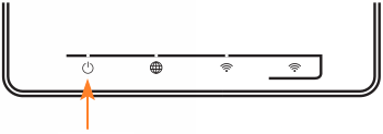

During the reset process, it is important to pay attention to the Status indicator (leftmost), which shows the device state.

Press the 'Reset' button using a sharpened thin object (e.g. a paperclip) and hold it in until the Status LED on the front panel starts frequently flashing (usually it takes 10 to 12 seconds), and then release the button.

Some models do not have a separate Reset button on the case, but this function is programmed into the 'Wi-Fi' button. Press and hold the Wi-Fi button until the Status LED (leftmost) on the front panel starts frequently flashing. Release the button and wait for the router to restart. This will erase the router's user settings and restore it to factory defaults.
  1. While holding down the Reset button, it is important to wait until the Status LED starts flashing. If you release the button before this moment, Keenetic will reboot without resetting the configuration.

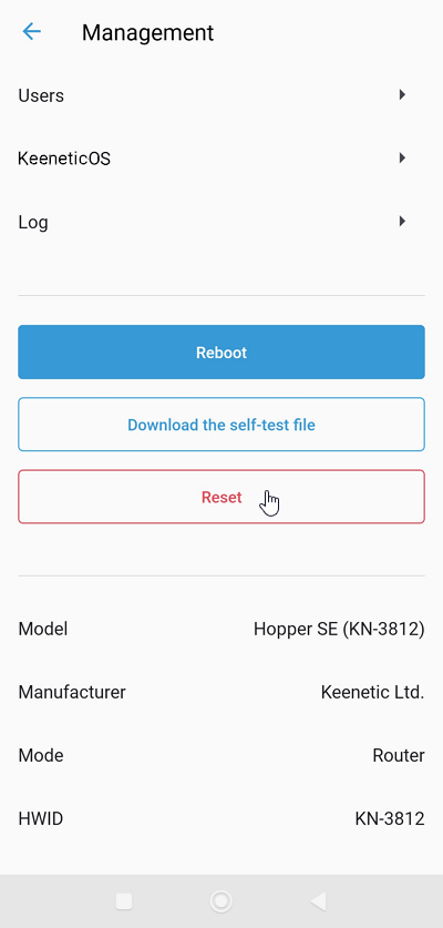

You can reset your router through the Keenetic mobile app. To do this, establish a connection with the router within the home network and run the application.
In the Keenetic app, in the router settings, go to the Management menu and at the bottom of the screen, click Reset.
