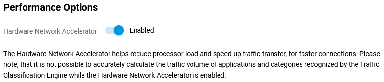

Connect to the web interface and ensure that the system component Network Accelerator Engine is installed. You can do this on the General System Settings page under KeeneticOS Update and Component Options by clicking on Component options.
Starting from KeeneticOS 3.7 in the router's web interface on the General System Settings page in the Performance Options section, there is a switch to turn the hardware accelerator on and off.
