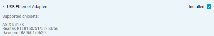

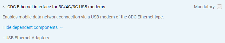

To support USB Ethernet adapters, two components must be installed in the router:
1. CDC Ethernet interface for 5G/4G/3G USB modems (mandatory, parent component)
2. USB Ethernet adapters (dependent component)
Avviso
The USB Ethernet adapters component supports the connection of adapters with the following chipsets:
  • ASIX 8817X
  • Realtek RTL8150/51/52/53/56
  • Davicom DM9601/9620
We recommend using Realtek 8152/53/56-based adapters as they are the most versatile.
