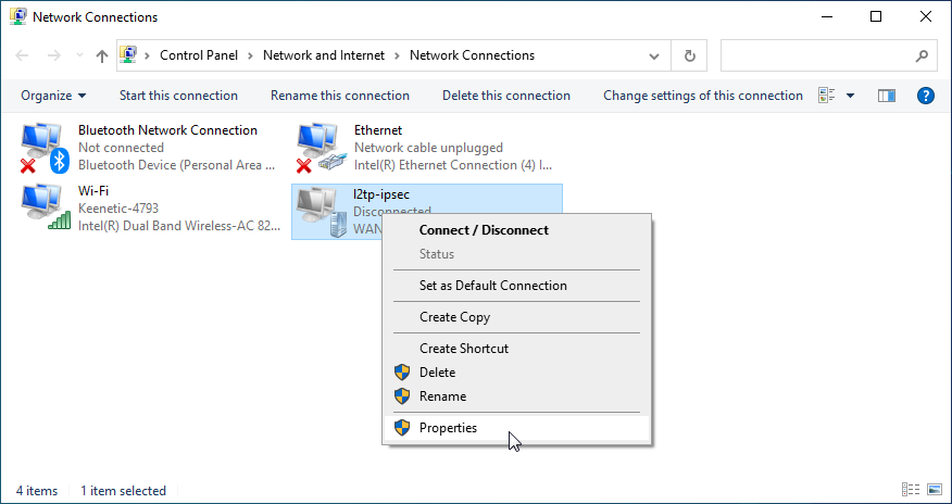

To manage these settings in Windows, you need to enter the properties of the VPN connection. To do this, open the Control Panel and go to Network Connections. Then right-click on the previously created VPN connection shortcut, and in the context menu, click Properties.

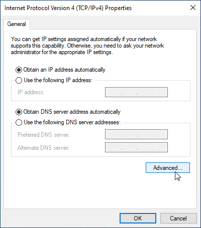

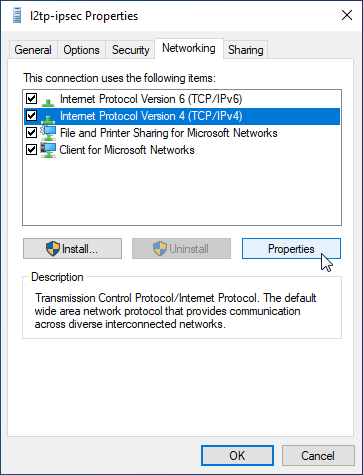

Go to the Networking tab, click on Internet Protocol Version 4 (TCP/IPv4) and then click on Properties.
Then click the Advanced button.

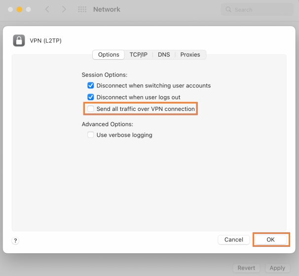

In macOS, the Send all traffic over VPN connection option is in the VPN connection settings:
If you disable this option, VPN is no longer used as the primary Internet connection.

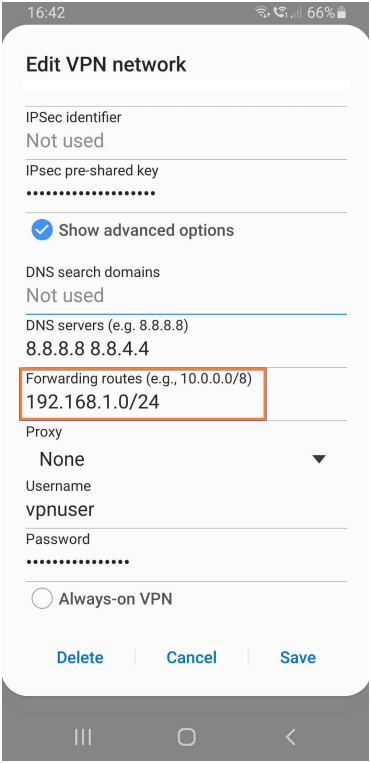

For Android OS, a similar effect is achieved by specifying particular networks to be routed to the VPN connection (a route to the local network of the router VPN server):
With this setting, only the specified subnet will be routed through the VPN tunnel, and the rest of the traffic will be sent to the Internet via the mobile device's primary connection.
