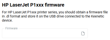

1.5. For HP LaserJet P1xxx series printers (the list of which is given above in section 1.4), the printer firmware in .dl format can be uploaded to the router. To do this, click the HP LaserJet P1xxx firmware link, specify the firmware file, and click Select. Firmware files for these printers can be found in the archive .
