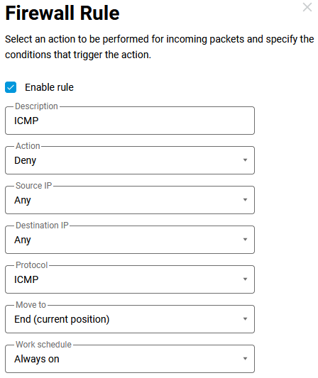

1. Suppose we use the web interface to create a rule that denies any ICMP protocol addresses for the external wired ISP interface.
In the configuration file, we will see the following settings:
access-list _WEBADMIN_GigabitEthernet1
    deny icmp 0.0.0.0 0.0.0.0 0.0.0.0 0.0.0.0
    deny description ICMP

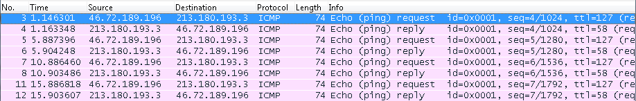

The specified list of rules is attached to the interface in the in direction (incoming). In this case, ping to external resources will not pass, but requests from the router and responses from the host will be visible on the interface. With this firewall rule, we will see ICMP request and reply packets in the dump.

As a result, ping to external resources will also fail, but ICMP traffic will no longer be visible on the interface, as it will be blocked before the request is sent.
