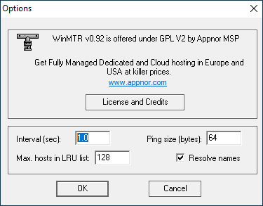

    In WinMTR, the default request interval is 1 second, and if this interval is not reduced, there will be no problems.
