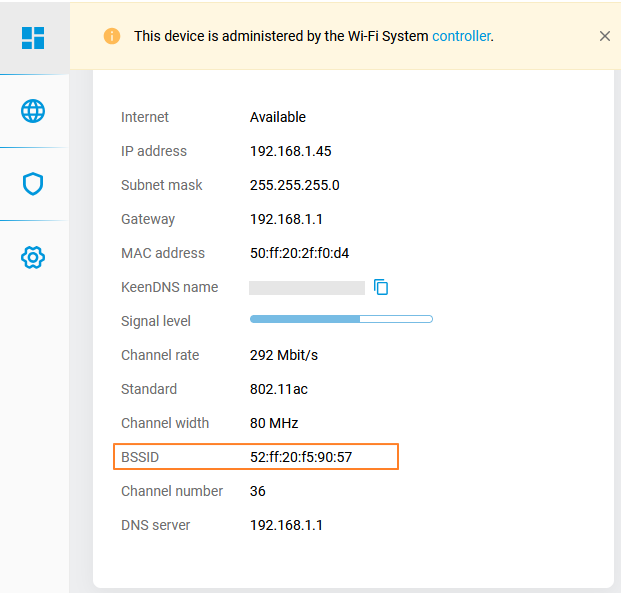

Question: There is a Wi-Fi System made up of Keenetic devices. There is one Main Router and two extenders connected by mesh Wi-Fi technology. Now the farther extender randomly connects to the Main Router (located far away) or to the nearer extender (located closer than the Main Router). Is it possible to configure the second extender to connect only to the nearest extender but not to the Main Router?
Answer: Yes, it is possible. If you want the far-end extender to connect only to the near-end extender, not to the Main Router, you can specify the BBSID (Wi-Fi MAC address) of the near-end extender. You can see it on the System dashboard page of the far-end extender when it is connected to the near-end extender. In our example 52:ff:20:f5:90:57 is the BSSID of the near-end extender:

In our example 52:ff:20:f5:90:57 is the BSSID of the near-end extender to be connected to.
The device configured in this way (the far-end extender) will then only connect to the specified BSSID (in this case, the first extender, not the Main Router).
