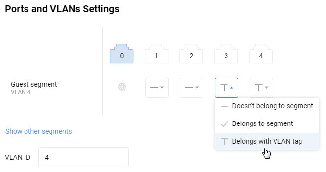

Question: Two segments are configured on the Wi-Fi System Controller — Home and Guest network, but when client devices connect to the Wi-Fi System Extenders, they cannot get IP addresses and therefore cannot connect to the network. How to properly configure the Guest network on the Extenders?
  • Answer: On your Main Router (Wi-Fi Controller), the settings for the Guest segment must be set to 'Belongs with VLAN tag' on the ports to which the Extenders are connected. In other words, the VLAN of the Guest network must be specified on the port used for the connection of the Extenders. For example, if Extenders are connected to ports 3 and 4 of the Main Router, the configuration should look like this:
    This setting is automatically made when acquiring into the Wi-Fi System, on the ports to which the Extenders are connected. If you have subsequently switched the wire from a repeater to a different port on the Wi-Fi System Controller, try returning the wire to the port in which the Extender was originally connected.
    If the Extenders are not directly wired to the Controller but to a managed switch, make sure that its ports, which include all nodes in the System, are trunked (i.e. it transparently passes 1522-byte 802.11q tagged frames) and that the STP protocol on these ports has been disabled.
    If you are using an unmanaged switch, you usually do not need to do anything. In rare exceptions, the reason for no connection between the Extender and Controller may be a very old switch that does not allow VLAN tagging.
    Once the ports involved in the Extender connection have been set to 'Belongs with VLAN tag', these network ports will operate with the VLAN tag, and you will not be able to assign them as WAN ports in this configuration. If you have such a task, you must first remove the VLAN tag from the port, and then it will be available to change the mode and use it as a WAN port.
