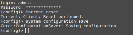

  1. To reset the settings, run the following commands from the command-line interface (CLI) of the router:
    (config)> torrent reset
    Once the above commands are executed, the configuration file settings.json will reset to factory settings.

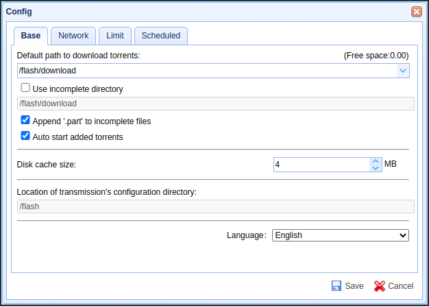

    Also, the 'Default path to download torrents', 'Use incomplete directory', 'Language' and other parameters configured in the Transmission web interface in the 'Config' menu will be reset to default settings.
    After the reset, you will need to reconfigure Transmission and try it again.

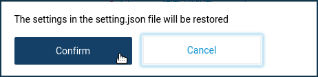

  2. It is also possible to restore the settings.json configuration file to factory settings in the web interface of the Keenetic router.
    To do this, go to the 'Applications' page, click on 'Download Station' and then in the window that appears, click on 'Restore settings.json'

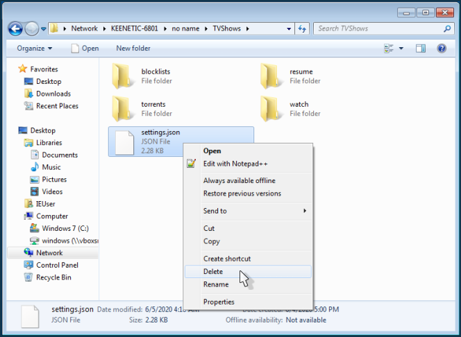

  3. Connect to the USB drive over the network (using Explorer or File Manager) or via FTP.
    Find the configuration file settings.json on it and delete it (in some cases, you may also need to delete dht.dat and stats.json files).
    Then, on the' Applications' page, in the router's web interface, turn the Download Station off and on again. The router will then create a new default configuration file, settings.json. Check the operation of the Transmission torrent client.
  4. You can delete the configuration file settings.json by disconnecting the USB drive from the router and connecting it directly to your computer.
    Use the FN button on the router case, which is designed to safely disconnect USB drives so that the information stored on them is not damaged. Before disconnecting the drive, stop its operation. Then press the FN button. The process will start, and once the USB indicator on the router stops flashing, you can safely remove the drive. Once the drive is plugged into the computer, find the settings.json configuration file on the drive and delete it (in some cases, you may also need to delete dht.dat and stats.json files).
    Then plug the USB drive into the router and test the torrent client operation.
