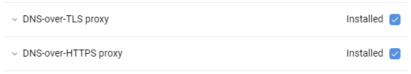

[en] For the DoT/DoH protocol to work, system components: 'DNS-over-TLS proxy' and 'DNS-over-HTTPS proxy' are needed to be installed. Please open 'System component options' menu by clicking on the 'Component options' button in the 'Management - System settings' section and mark the required components for installation.

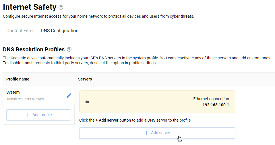

[en] Proceeding then with the setup on the 'Internet safety' page under the 'Network rules' menu section. Navigate to 'DNS configuration' tab and click the 'Add server' link at the bottom of the page.
DNS-over-TLS

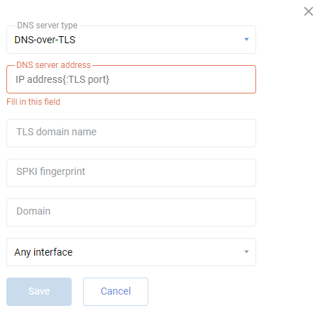

Click the Add server link at the bottom of the page.

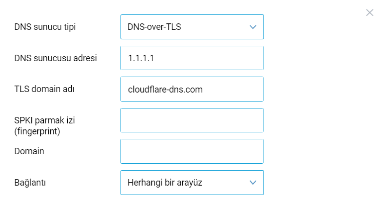

[en] The fields for filling in the server parameters will appear. Specify the DNS server address (in our example 1.1.1.1 and 1.0.0.1), the TLS domain name (in our example cloudflare-dns.com), and, if necessary, the Connection interface (the default setting is 'Any interface').
[en] For example:
[en] In the 'DNS server address' field, it is allowed to specify the FQDN domain name, e.g.:
İpucu
In the DNS server address field you can specify the IP address of the server (8.8.8.8) or the FQDN domain name (dns.google), as well as the address with the TLS-port, for example 8.8.8.8:853 or dns.google:853 (it is not necessary to add the TLS-port, because the system automatically substitutes the port 853).

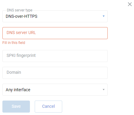

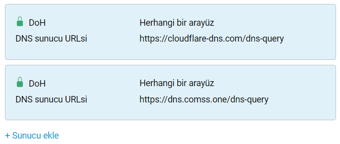

Click the Add server link at the bottom of the DNS Configuration tab.
[en] Click the 'Add DNS-over-HTTPS server' button. In the fields that appear, it is required to DNS server URL and, if necessary, specify the Connection interface (the default setting is 'Any interface'). In our example, the https://cloudflare-dns.com/dns-query and https://dns.comss.one/dns-query servers are added.
[en] For example:

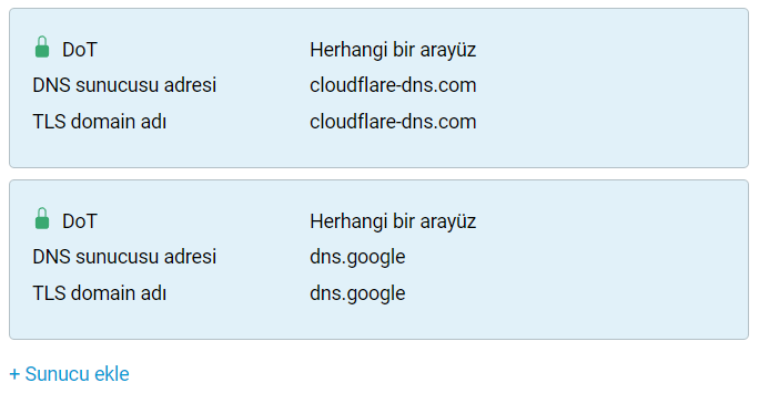

[en] When multiple DNS-over-TLS and/or DNS-over-HTTPS servers are specified in the router settings, the system resolver will use them in the order of priority on the measured response time.
A maximum of 8 DoT/DoH servers can be used in Keenetic routers.

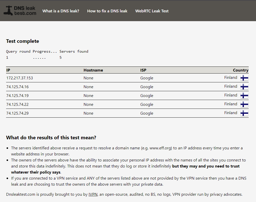

Cloudflare servisi de doğrulama sayfaları sağlamaktadır. https://www.cloudflare.com/ssl/encrypted-sni/ adresinden özel bir web sitesi açalım ve tarayıcı güvenliğini beraber kontrol edelim.
In our example, DNS requests go through Google servers.

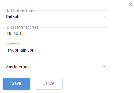

  3. [en] To prevent a DNS query from being hijacked, you must specify the domain in the DNS server add settings. For example:

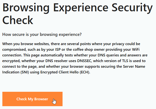

  4. You can check DNS queries for the Cloudflare service by visiting https://www.cloudflare.com/ssl/encrypted-sni/
    Click Check My Browser to run the test.

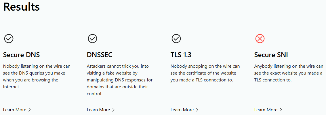

    If DoT/DoH is configured correctly, the test should complete successfully for Secure DNS, DNSSEC and TLS 1.3. The correct output of the DoT/DoH and browser security test depends on the availability of DoT/DoH servers/addresses in the ISP/mobile operator network.
This is an example of DoT/DoH validation for Cloudflare. If you use other DNS services, the check on https://www.cloudflare.com/ssl/encrypted-sni/ may fail. It will also fail if any DNS addresses have been specified in the DHCP settings of the Keenetic home network. In this case, the devices connected to Keenetic will address these DNS servers directly, not Keenetic with DoT/DoH configured.
To run the test again, click Run the test again.
If the test fails, it is possible that third-party DNS servers were previously defined in the IP settings of the network adapter in Windows, Linux, and macOS operating systems. In this case, all DNS queries will be processed through third-party DNS, and DoT/DoH will not work. Delete the previously specified third-party DNS addresses and repeat the test.
Also, keep in mind that if you specify multiple DoT/DoH addresses from different services, the result of the test depends on which server is currently in priority. For example, if a DoH server https://dns.google/dns-query is specified in DNS message format, it fails the Secure DNS check.
