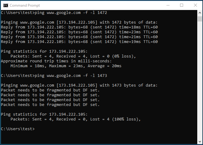

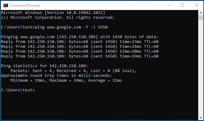

Here is an example. Let's ping
www.google.com with a packet size of 1450 bytes
ping www.google.com -f -l 1450
After pinging, you will immediately see the result. In our example, we got a response, and no packet fragmentation request message was received. So we will now proceed with our test. First, start testing the packet size at 1450 bytes
, and gradually increase this value until you see the Packet needs to be fragmented message
So, in our example, we found the maximum size of the packet to be 1472 bytes
(at this value, the packet does not need to be fragmented) because at 1473 bytes
, the message saying that the packet needs to be fragmented appeared.
But this is not the MTU value yet. We have got the MSS (Maximum Segment Size) value, which defines the maximum size of the data block in bytes. This parameter does not take into account the length of the ICMP and IP headers. In our case MTU value = MSS + IP header + ICMP header.
Now let's add 28 bytes
reserved for the data header (20 bytes
for the IP header and 8 bytes
for the ICMP request header) to the number obtained during the test. Thus, for our example, MTU=1472+28=1500 bytes
(this is the optimal value for the MTU parameter).

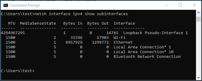

Sometimes you need to know the MTU value of your computer when you connect directly to it with your ISP's Internet cable. To see the current MTU value, use a special command from the Windows command line:
netsh interface ipv4 show subinterfaces
You will see information on all interfaces on the computer. See the MTU value for the main connection (in our example, it is 1500
for the Ethernet interface).
