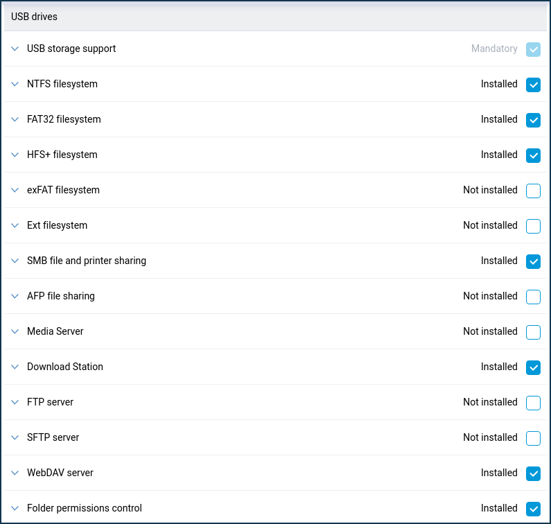

  2. Open the router's web interface in your browser and make sure that the router's system components responsible for working with the USB interface and USB storage devices, as well as support for storage file systems, are installed in the router's settings. You can do this on the General System Settings page under KeeneticOS Update and Component Options by clicking Component options.
    Make sure that the most important SMB file and printer sharing component is installed, as well as the components for your drive's file system. For example, if you connect a USB drive with the NTFS file system, the NTFS filesystem component must be installed; if you connect a USB drive with the FAT32 file system, the FAT32 filesystem component must be installed.
    Support for Ext file systems has been moved to a separate component. When you connect a USB storage device with the Ext2/Ext3/Ext4 file system, the Ext filesystem component must be installed.

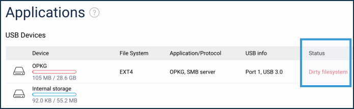

  5. If in the router's web interface, under USB Devices in the connected drive entry, you see a Dirty filesystem status, you need to check the drive or USB stick for errors on your computer.

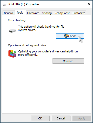

    1. Connect the USB drive to a Windows computer and check it for errors using standard operating system tools or the CHKDSK utility.
      The easiest way to check the drive in Windows is to use File Explorer. Connect the drive to your computer. Start Windows Explorer, right-click on the drive you want to check for file system errors, select Properties, click the Tools tab, and click Check.

      Sometimes, in the system log of the router (on the page Diagnostics > Show log), you can see messages of the following kind:
      • ndm: FileSystem::Ext: failed to mount "SAMSUNG": filesystem is dirty, please perform a chkdsk maintenance of this drive on your Windows computer.
      Usually, the filesystem is dirty label is detected on drives that have been previously incorrectly (unsafely) disconnected from the computer or another device. In this case, it is enough to connect the drive to the computer, check it for errors and then correctly disconnect it using the Safely Remove Hardware feature of the operating system.
      Also, the above label may appear on some USB drives after the drive has come out of hibernation mode. If this happens, connect the drive to your computer and check for errors. For disks with the FAT file system in Windows 10, you can use the command chkdsk G: /markclean (as an administrator), where G is the letter assigned to the connected drive.
