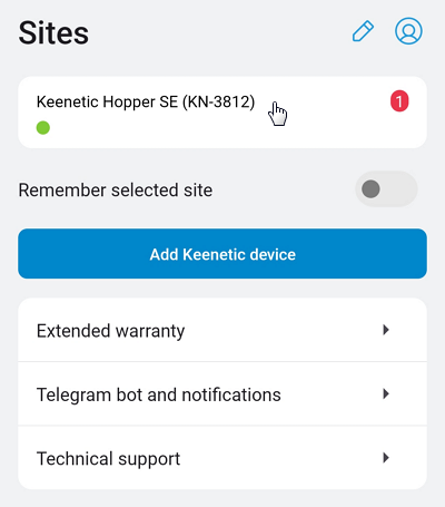

  5. After adding your router to the app, you will have access to its settings.
    The start screen will show you all the routers you have added for management. Tap on the device whose settings you want to connect to.
    Information describing the app features and available settings can be found in the Keenetic Mobile Application section.

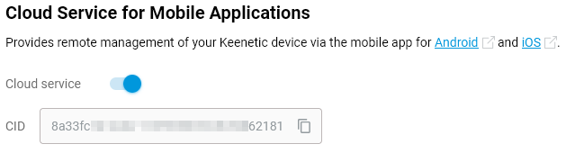

    In case for some reason, you are unable to set up a remote connection to your router via the app, please note the following:
    • Make sure that the system component Service for mobile application is installed. You can do this in the web interface on the General System Settings page in the Update and Component Options section by clicking on Component options.
    • Make sure that Cloud service is enabled.
      This setting can be found in the Cloud Service for Mobile Applications section on the General System Settings page.
