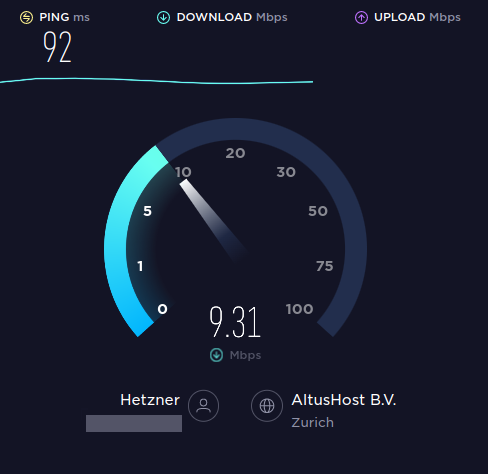

One of the most popular services is Speedtest. But you can also use other similar online services, such as nPerf.
We want to point out some special features when using it. The service automatically selects the optimum server to test the speed by default. But it is important to consider the location of the server itself. Sometimes the service does not correctly choose the server to be tested. The service allows you to specify the server manually. To do this, click the link Change Server, choose the server and then run the test.
You will get three figures from the test: Ping, Download speed (speed of incoming connection; speed from Internet to subscriber) and Upload speed (speed of outgoing connection; rate from subscriber to Internet). Ping indicates the time (in milliseconds) it takes for a special network packet sent from the client to reach the selected server and receive a response (the shorter the time, the better). Incoming connection speed affects how quickly websites are opened, and files are downloaded from the Internet. Outgoing connection speed is used when transferring data from your computer to the Internet (for example, when uploading photos or files to the cloud).
Another popular online service is nPerf. It also allows you to check the speed of your Internet connection.

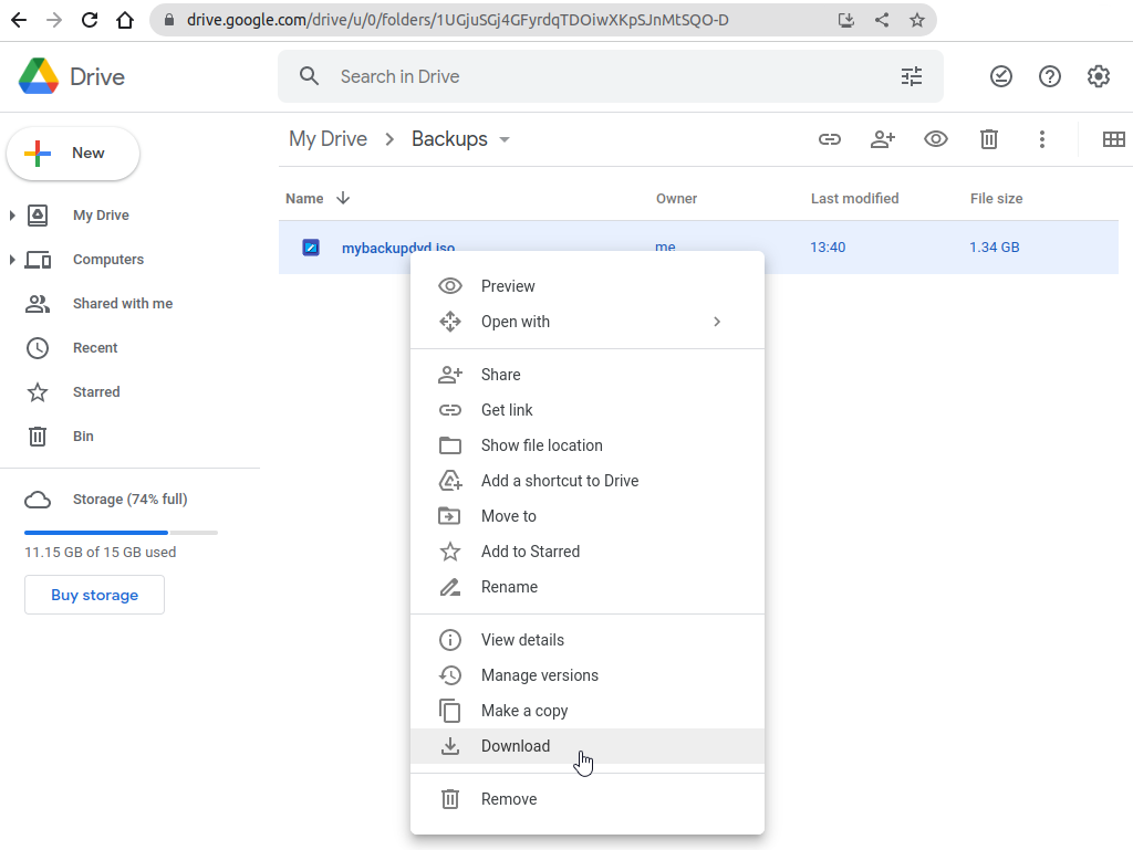

You can download a file to your computer that you have previously placed on a cloud service (e.g. from Dropbox or Google Drive).
Here is an example. A file of 1.34 GB has been uploaded to Google Drive. Then, download the file from the cloud to your computer, but be sure to determine when the file was downloaded using a clock or stopwatch.
In this case, the download of a 1.34 GB file was 1 minute and 20 seconds (80 seconds). Now divide the file size (in Megabytes) by the download time (in seconds): 1340/80=16,75 Mbyte/s. Internet speed is usually specified in Megabits, so convert Megabytes to Megabits by multiplying the previously calculated value by the number 8: 16,75*8=134 Mbit/s. In our example, the value of 134 Mbit/s is approximately the same as the claimed internet speed of 150 Mbit/s.
