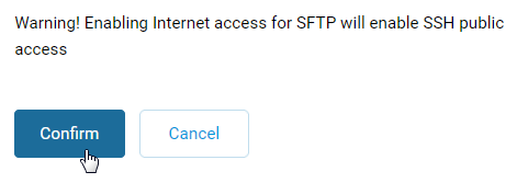

If you want to access the SFTP server from the external interface, enable the Allow access from the Internet option. You will see the following message: Warning! Enabling internet access for SFTP will enable SSH public access. Click on Confirm.

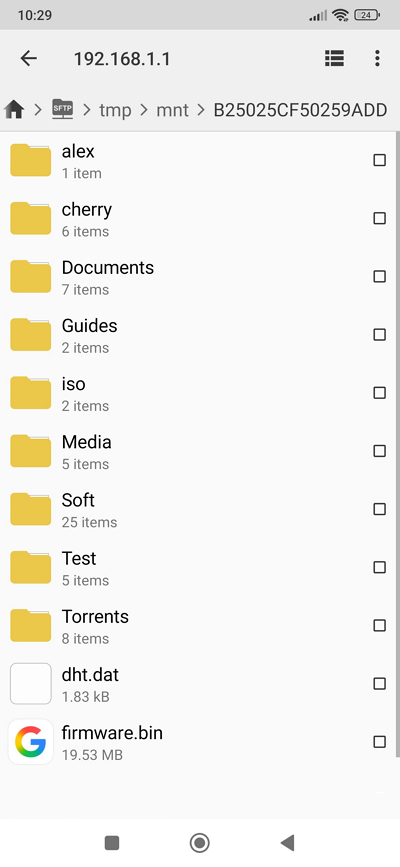

If the connection is successful, you will see the folders and files on the USB drive.
