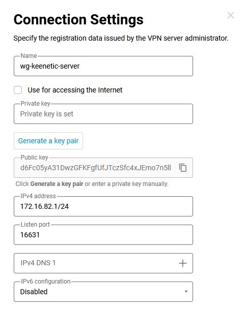

First, you need to configure the WireGuard server on the Keenetic device. The following instruction shows the process: Configuring a WireGuard VPN between two Keenetic routers. Then move on to the VPN client setup.

  5. Set up a remote connection on the side of the previously configured WireGuard server.
    Connect to the router's web interface and go to the Other connections page in the Internet section. Click on the previously created WireGuard connection (wg-keenetic-server) and add the peer's settings. Click on Add peer to open the peer settings window, in which you specify the name of the tunnel wg-ubuntu-home.
    In the Public key field, insert the key created in step 2.

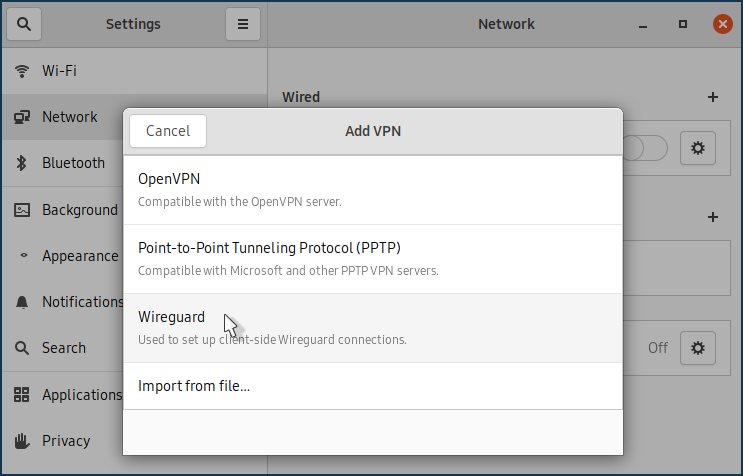

A variant of installation and configuration using NetworkManager
NetworkManager GUI is a graphical shell for network connection management software.
Brief command sequence:

  3. Reboot the computer and check the availability of Wireguard settings in the Network Connections panel:
Configuring the connection to the Wireguard server:

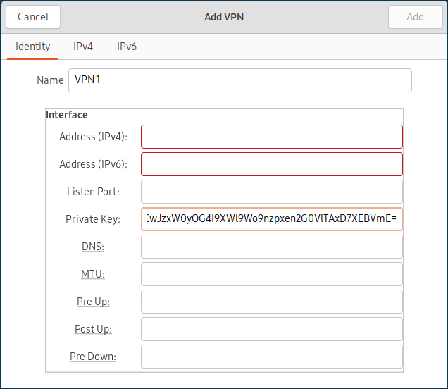

  1. Generate Private and Public keys, as described in A variant of installation and configuration using the terminal (2nd step).
    If the keys were previously generated in the system, you would need to view them in the terminal and copy them to the clipboard one by one:
    [my@my-wrk-lnv wireguard]$ sudo cat private-key
    0CwJzxW0yOG4I9XWl9Wo9nzpxen2G0VlTAxD7XEBVmE=
    [my@my-wrk-lnv wireguard]$ sudo cat public-key
    M2LeCzN8mFLpa6Xz3BNHFgtNt8kY4wluiwt+NJFTgxk=
  2. Copy the Private key and paste it into the Private Key field of the tunnel settings:
  3. Copy the public key and paste it into the previously configured WireGuard server in the Public Key field.
    In the Allowed v4 IPs field, specify the address from which traffic will be allowed to the server in IP/bitmask format — 172.16.82.8/32
  4. In the Public Key field, enter the public key of the server, which can be copied to your computer's clipboard from the WireGuard settings in the router's web interface:
    In the Allowed IPs field, specify allowed IP addresses in IP/bitmask format — 172.16.82.1/32 (the internal server address) and 192.168.22.0/24 (address of the local segment of the Keenetic router).
    In the Endpoint field, specify the public IP address or domain name of the WireGuard server and the listening port on which the WireGuard client will establish the connection.
    In the PersistentKeepalive field, specify the frequency of attempts to check the availability of the remote side of the connection. Usually, a 3-5 second interval between checks is enough.
  5. In the IPv4 tab in the Routes section, add a route to the local network segment of the Keenetic router:
  6. Connect to the Wireguard server and ensure there are no error messages.
