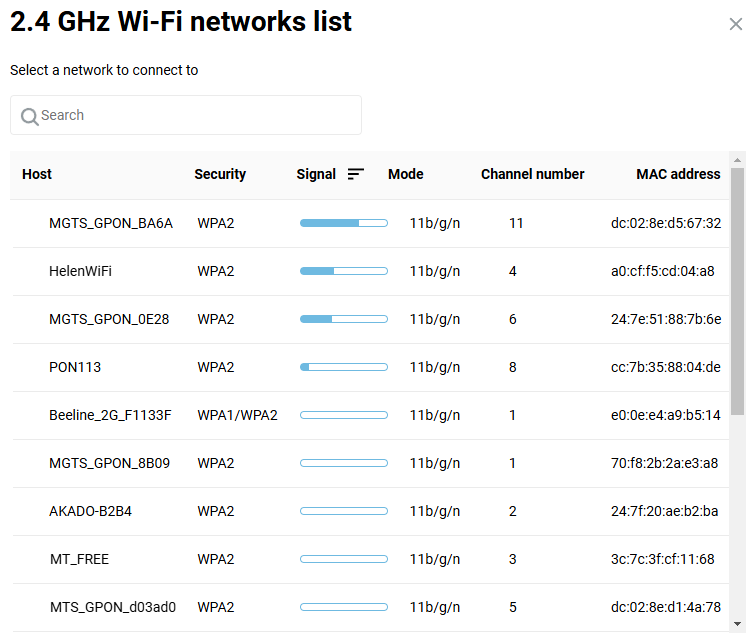

Connect to the web interface, go to the 'Wireless ISP' page, and click 'Scan for a network'.
You will see the available Wi-Fi networks within the range of the Keenetic in the displayed window.
The 'Channel number' column shows the channel numbers on which the neighbouring access points are running. The 'Signal' column shows the wireless signal level (power).
We recommend you to set the number of one of the free non-intersecting wireless channels (for the 802.11n protocol, non-intersecting channels are 1, 6 and 11 with a channel width of 20 MHz, and with a channel width of 40 MHz they are channels 3 and 11). But if these channels are already used by other access points, in this case, choose a channel on which the neighbouring points have a weak signal and rarely used.
In the example above, you can see that there is a free channel 3 in the radio air and in this case, you should use this channel.

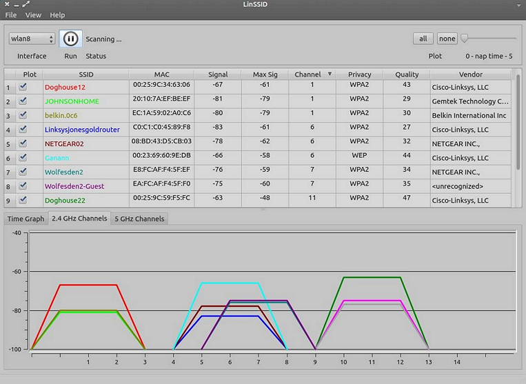

LinSSID (for Linux OS)
