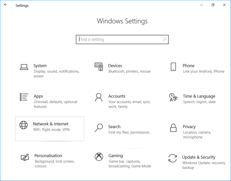

To connect to an SSTP server, you need to add a VPN connection to the Windows computer. To do this, go to the Windows Settings menu and open the Network & Internet section.
Then go to the VPN settings.

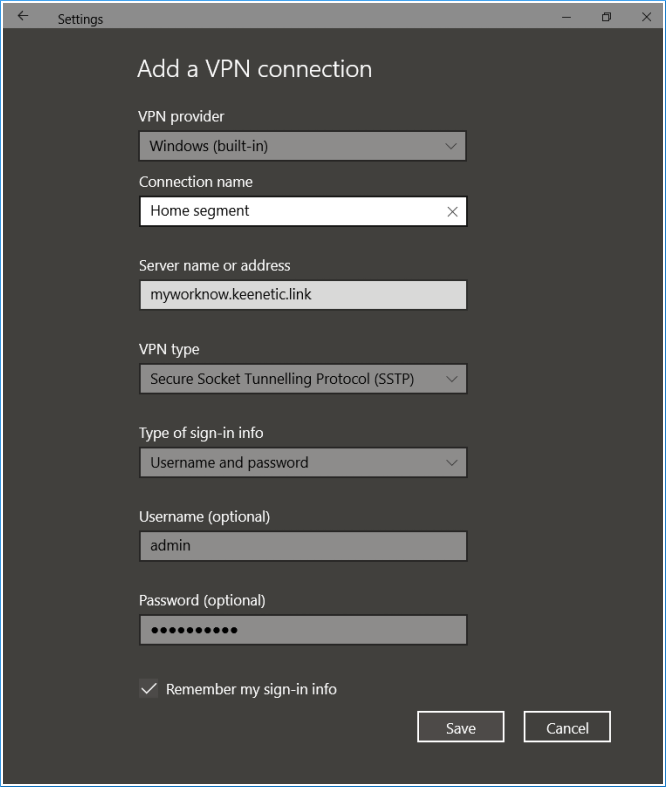

In the window that opens, you must enter the following settings:
- VPN provider — Windows (built-in)
- Connection name — any custom name for identifying the tunnel, e.g. - Home segment.
- Server name or address — domain name registered for the router at KeenDNS.
- VPN type — SSTP protocol
- Type of sign-in info — Username and password
- In the Username and Password fields, you can specify your router account details so that you do not have to enter them every time you connect and click the Save button.

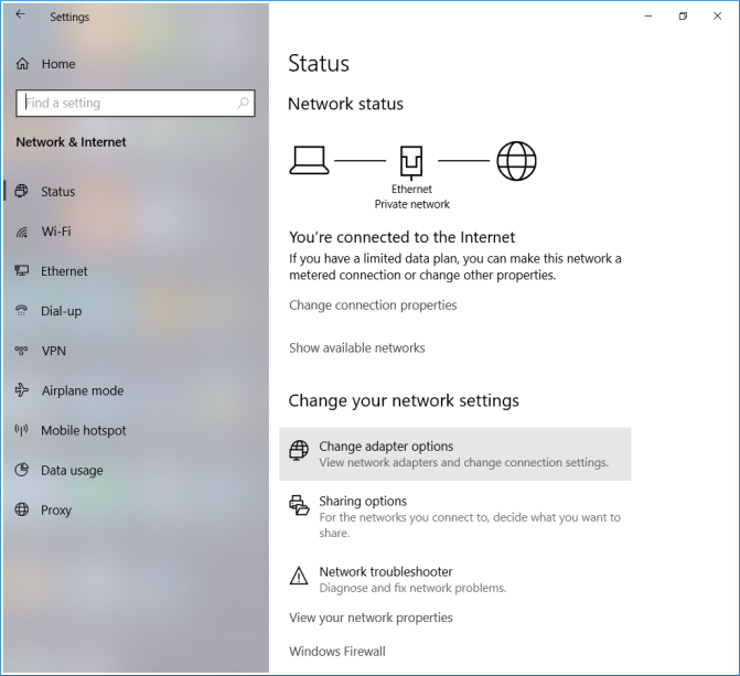

To prevent your computer from using a tunnel to access the Internet, but only to connect to the router's local network, you will need to configure the VPN connection settings further. Go to the Change adapter options menu, which is available under Change your network settings (via the Network & Internet — Status view).

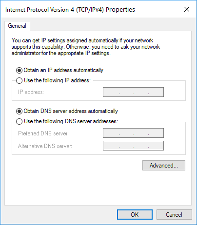

The tunnel property setting window opens. On the Networking tab, select the Internet Protocol Version 4 (TCP/IPv4) component and click on the Properties button.
In the TCP/IPv4 property setting window, click the Advanced button.
On the IP Settings tab, in the Advanced TCP/IPv4 Settings window, you must disable the setting Use default gateway on remote network. To apply the setting, close this window and the additional windows that caused it to open using the OK button.

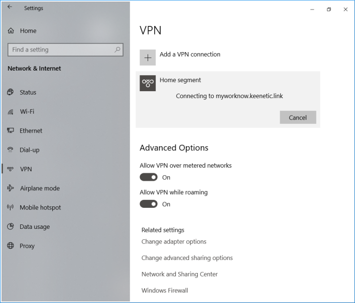

The configured connection is displayed in Network & Internet — VPN or in the Network menu in the system notification area (at the bottom right of the screen).
When the tunnel is established, you can access the resources of your Keenetic local network on your computer.

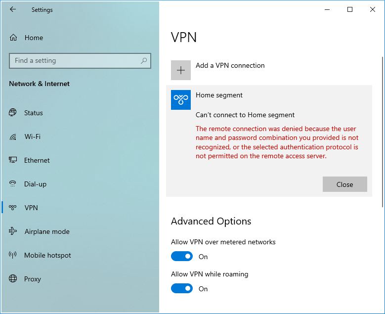

 Occasionally, in some versions of Windows 10, when you create a new SSTP VPN connection, the MS-CHAPv2 authentication protocol is not activated by default for some reason and you may see a message when you connect: The remote connection was denied because the user name and password combination you provided is not recognized, or the selected authentication protocol is not permitted on the remote access server.
In this case, in the properties of the SSTP connection, enable the use of Microsoft CHAP Version 2 (MS-CHAP v2) and save the setting.
Then check the server connection.
