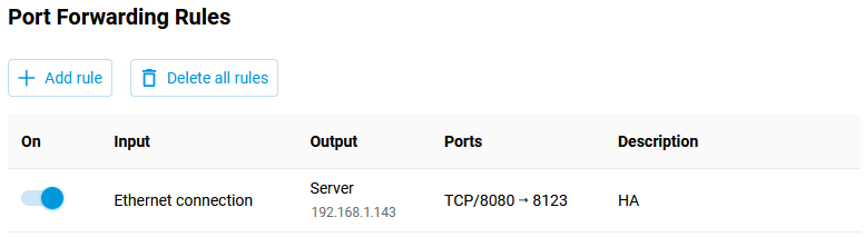

Let's look at an example of configuring remote access to the interface of a popular open-source Home Assistant intelligent home application (running on port 8123) on a home network.
Similarly, you can set up remote access via HTTP protocol to any device on your home network with a web interface (a webcam, network drive, router, server, etc.).
The configuration will be done through the router's web interface.
  1. First, you need to register the devices to which remote access will be given on the router. For more information, see the article Registrazione dei dispositivi connessi.
  2. Go to the Port Forwarding page and create classic port forwarding rules for the external interface to the desired devices.
    Since the classic port forwarding mechanism is used, it is impossible to forward the same access port to different devices, unlike the configuration via a fourth-level domain. Suppose the router's web interface is accessible from the Internet on port 80, and you want to provide access to the web interface of a host on the local network, which also runs on port 80. In this case, you need to do a port mapping (e.g. external port 81 is translated to internal port 80). In the case of fourth-level domains, this problem is solved because each host has its own domain name.
  3. You can then check access to the specified hosts. Although a private IP address is obtained from the ISP, access will be granted according to the defined rules.
In our example, the interface of the Home Assistant will be available at http://myrouter01.keenetic.pro:8080
