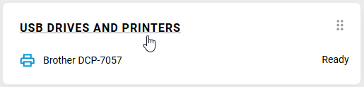

On the 'System dashboard' page, ensure that the connected printer is detected and visible in the 'USB drives and printers' information panel. The printer status must be 'Ready'.
In this example, we connect the Brother DCP-7057 printer.
Click on the link 'USB drives and printers' to go to the 'Applications' page.

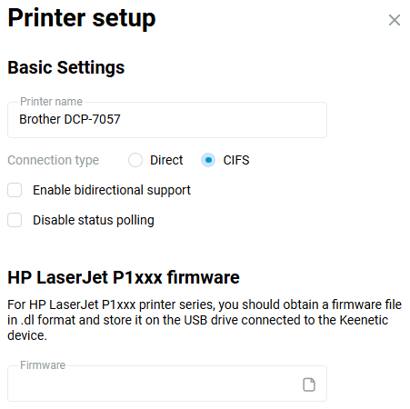

On the 'USB Devices' section, you can manage the connected printers. Clicking on the connected printer will take you to the printer's advanced settings.
By default, the printer is connected via the CIFS protocol, and the bidirectional mode is disabled.
For HP printers of the LaserJet P1xxxx series, you can upload the firmware in
*.dlformat to the router. In the ‘HP LaserJet P1xxx firmware’ section, specify the firmware file and click 'Select'. Some firmware for these printers can be found in the archive fw_dl_hp_laserjet_1xxx.zipAs mentioned above, CIFS is the default printer connection, but if your printer fails to print, change the connection type to 'Direct'. For details on setting up this type of connection, please refer to the 'Connecting a printer in Direct mode' manual.
