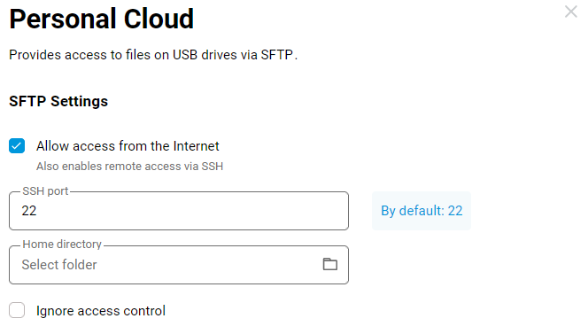

You will see the window, the main server settings, and user management options are presented in the SFTP Settings section.
If you want to access the SFTP server from the external interface, enable the Allow access from the Internet option. You will see the following message: Warning! Enabling internet access for SFTP will enable SSH public access. Click on Confirm.
You can find the port number that uses the built-in SSH server in the SSH port field. The server uses the standard TCP port number 22 for the connection by default. If necessary, you can change the port number (for example, use 2022). We recommend doing this to improve the security, as the standard ports are often exposed to attacks on the Internet.
If the Ignore access control' option is enabled, the connection to the SFTP server will be available to all users without authorization. We recommend not using anonymous access but setting up access rights to the SFTP server with authorization (in this case, when connecting to the SFTP server, the user will have to enter a username and a password).

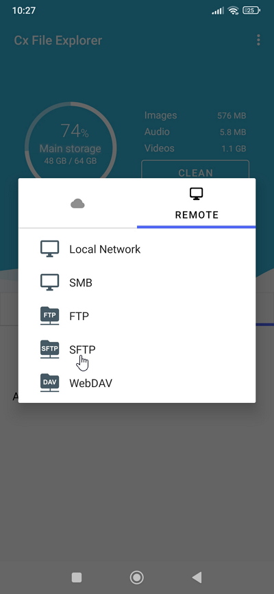

Run the Cx Explorer application on your Android mobile device.
Add a connection on the Network tab.
Go to the Remote tab and select the SFTP protocol.
Specify the router's IP address in the Host field (for access from the Internet, it is a WAN IP address, and for access from the local network, it is a LAN IP), the SSH port number, and the username and password of the router user account.
To connect to the router via third-party applications, we recommend creating a separate user account, only allowing access to the SFTP server. For security reasons, do not use the router's administrator account; specify a user account with restricted rights.
Press OK to continue.

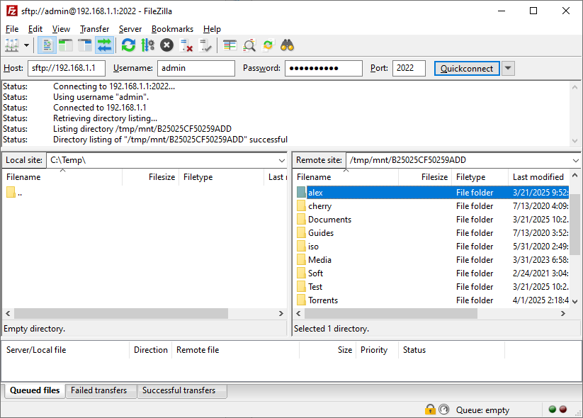

You can also use any file manager or client with the SSH FTP protocol support on your computer.
Here is an example of a connection using FileZilla and WinSCP programs:
