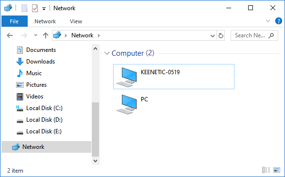

  4. Below is an example of configuring the network access to USB storage from Windows. Use Run or open the Explorer file manager. Type the local IP address of the Keenetic in the address bar,  with \\ in the beginning (in our example, it's \\192.168.1.1). You can use network name of the Keenetic, example \\Keenetic-0519.
    If the router is in the same workgroup as other computers on your home network, you can access the USB drive through your Network Neighborhood (Network).
    If you don't see the name of your router on your computer in the network, refer to the article Troubleshoot USB drive access via Windows network.
