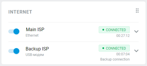

1. Check that the Backup ISP connection is active and in Connected state:

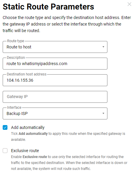

4. Create a static route to the IP address 104.16.155.36 of the whatismyipaddress.com domain in the router settings:
In Static Route Parameters, select:
Route type: Route to host;
Destination host address: 104.16.155.36 (this is the address of the domain whatismyipaddress.com);
Interface: the name of the interface through which routing will be carried out (in our example, this is Backup ISP).

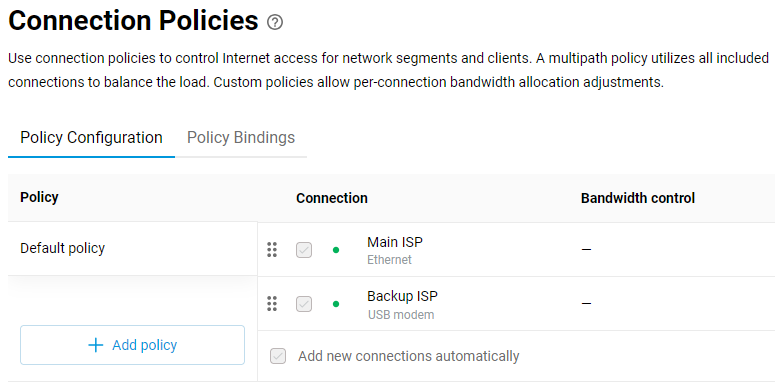

If Connection Policies are configured, the interfaces of the main Internet provider and the backup connection must be in the same policy.
