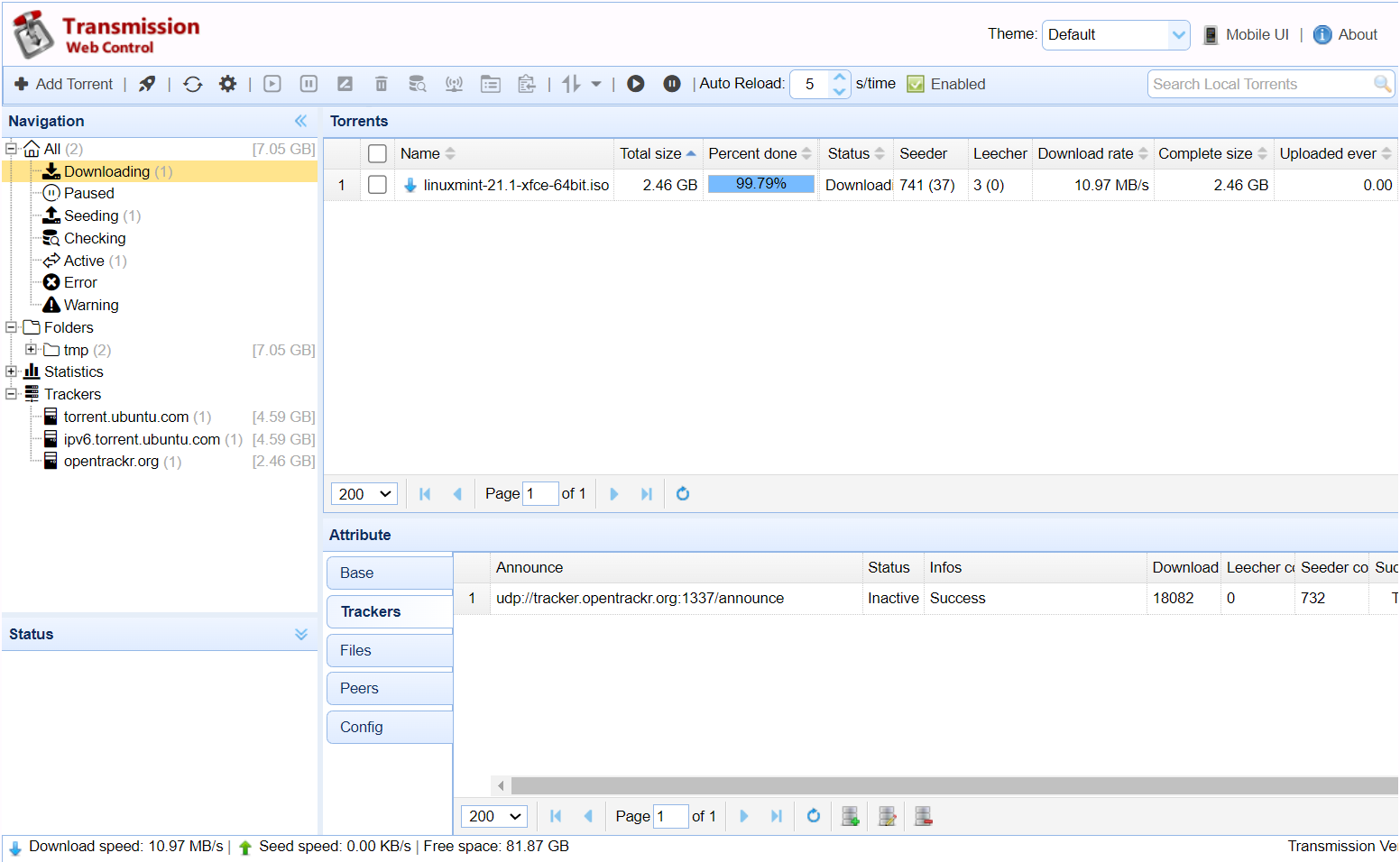

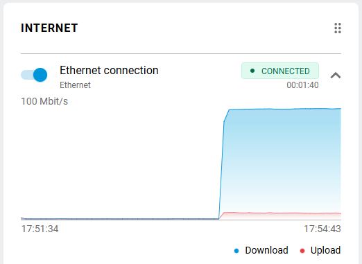

For the test, we connect an SSD drive to a Keenetic and, on default settings, get the following speeds:
In our example WAN port speed is 100 Mbit/s, the tariff is up to 100 Mbit/s too, and the torrent client has a download speed to disk up to 100 Mbit/s = up to 11 Mbytes/s:

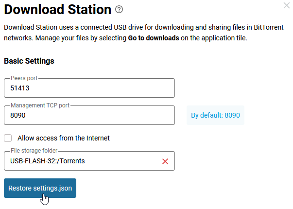

  1. Connect the USB storage to the router.
  2. In the web interface, go to the Applications menu under Download Station and delete the application configuration file by clicking Restore settings.json:

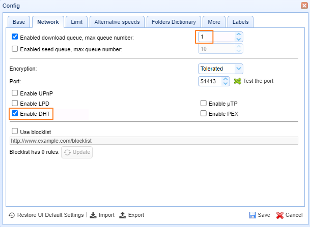

  3. Go to the torrent client interface (GUI), check Enable DHT and set the Enable download queue, max queue number field to 1:
