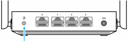

Every Keenetic device has a 'Reset' button on it. You can find it on the same side where the rest of the ports are located (the exact button location depends on the model).

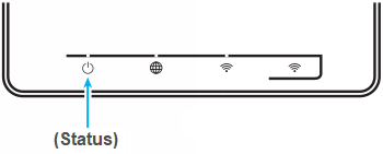

During the reset process, it is important to pay attention to the 'Status' indicator (leftmost), which shows the device state.

Press the 'Reset' button using a sharpened thin object (e.g. a paperclip) and hold it in until the 'Status' LED on the front panel starts frequently flashing (usually it takes 10
to 12
seconds), and then release the button.

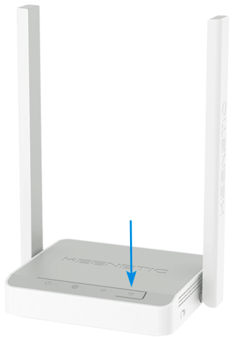

Some models do not have a separate Reset button on the case, but this function is programmed into the 'Wi-Fi' button. Press and hold the 'Wi-Fi' button until the 'Status' LED (leftmost) on the front panel starts frequently flashing. Release the button and wait for the router to restart. This will erase the router's user settings and restore it to factory defaults.
While holding down the 'Reset' button, it is important to wait until the 'Status' LED starts flashing. If you release the button before this moment, Keenetic will reboot without resetting the configuration.
