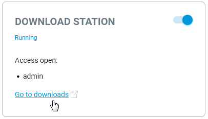

To securely connect to the Transmission interface remotely over the Internet, we recommend establishing an HTTPS connection to the router's web interface using the KeenDNS domain name or via a VPN connection to the router. Then directly from the web interface, from the System dashboard or Applications page, click on the Go to downloads link.

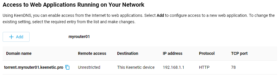

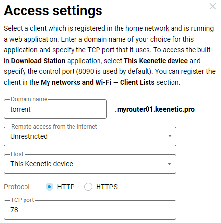

In the Domain name menu, under Access to Web Applications Running on Your Network, make the fourth-level domain setting to access the interface of the built-in torrent client:

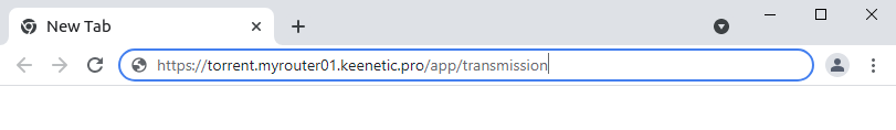

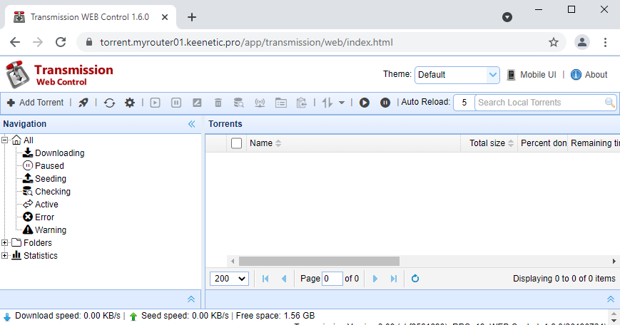

Once configured, the Transmission interface will be accessible in a web browser using a fourth-level domain name from the Internet, as follows:
https://xxxx.xxxx.keenetic.xxxx/app/transmission

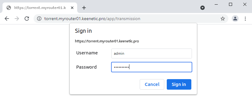

Launch your browser and enter the domain name of your router in the address bar, then add /app/transmission
at the end of the address.
This address will automatically switch to the secure HTTPS protocol when opened.
In our example, the Transmission interface is available at https://torrent.myrouter01.keenetic.pro/app/transmission

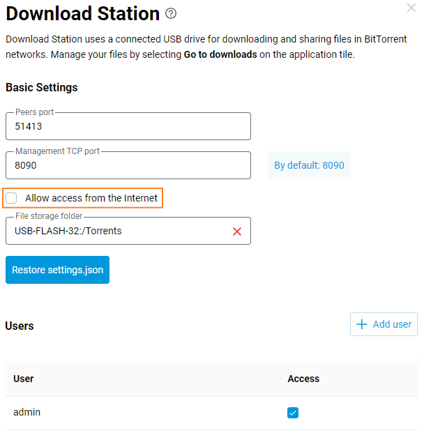

Tip
For extra security, we recommend that you disable the Allow access from the Internet option in your torrent client settings, ensuring that the HTTP/8090
port is always open for the RPC.
