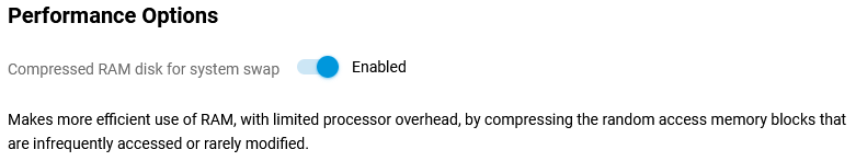

From KeeneticOS 3.7
onwards, zRAM can be enabled in the router's web interface under 'Management' on the 'General system settings' page under 'Performance options'.
Set the 'Compressed RAM disk for system swap' switch to Enabled.
Tip
For more information, see the System performance settings: zRAM virtual swap file and HWNAT traffic accelerator article.
