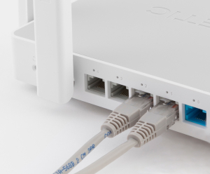

All Keenetic router models have a built-in Ethernet switch with network ports (sockets). The blue 0 port is for connecting the Internet cable from your ISP, and the other ports are for home devices.
A Fast Ethernet switch provides connection speeds of up to 100 Mbit/s for network devices, and a Gigabit Ethernet switch — up to 1000 Mbit/s (1 Gbit/s).
Ethernet cable networks use twisted pair cable as the physical medium for signal transmission. The cables are connected to the network devices using an 8P8C connector (plug).

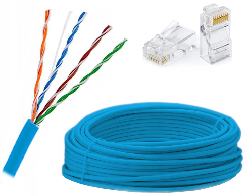

For a stable and reliable Internet connection, a cable must have the following characteristics:
  • A category 5 standard or higher;
  • 8-core copper, not copper-coated aluminium based;
  • the cable must be properly and firmly crimped (8P8C connectors fitted correctly on both sides of the cable);
  • Length must not exceed 100 m;
  • no kinks, knots or twists.
These are the standard features that Keenetic routers comply with. The most common cable used today is either 8-core (4-pair) Unshielded Twisted Pair (UTP) or Shielded FTP (Foiled Twisted Pair) category 5/5e cable.

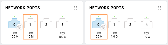

If the link speed is 10 Mbps, this often indicates that there is a problem with the connection. If the computer is not switched off and is not in 'sleep' mode, it most often indicates that there is a problem with the cable. If you connect a Gigabit Ethernet adapter to a Gigabit router, using a Cat. 5 or higher 8-core cable and see a connection speed of 100 Mbps instead of 1 Gbps, it usually indicates a bad network cable as well. You can check the speed in the router's web interface on the System dashboard screen.

If you see a connection speed of 100 Mbit/s instead of 1 Gbit/s when connecting to a gigabit router after re-crimping the cable, ask your ISP to switch your Internet cable to another port on the switch or to another switch if possible. The problem may be related to a switch port on the ISP side.

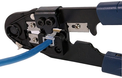

If you have a network cable crimping tool, you can crimp and replace the connector on the Internet cable yourself. For more information on this, see Crimping a network cable by yourself below.

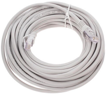

Cable (patch cord) for the connection of home devices
To connect home network devices to the router, we recommend using factory-made patch cables. These cables are now available almost everywhere in almost any length — UTP/FTP, RJ-45, Cat. 5e (8-core), standard lengths of 3, 5, 7.5, 10, 15, 20, 30, 50, 100 m.
For high-quality, reliable connection of devices at 1 Gbit/s, use 8-core factory-manufactured category 5 or higher cables.
If you have a network cable crimping tool, you can make your own patch cable at home, but be very careful to crimp the connectors correctly and properly. For more information on this, see Crimping a network cable by yourself below.

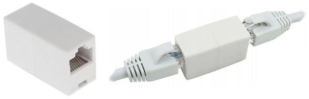

Sometimes, a poor-quality RJ45-RJ45 / 8P8C straight-through connector adapter (also called a 'barrel') can cause poor network infrastructure performance. It is usually used to extend the length of a line and allows two shorter patch cords to be used when cable lengths are insufficient.
If your network uses such a connector adapter and you are experiencing problems with the network link, try connecting the cable directly (without an intermediate adapter) to the router or replace the connector adapter.
We recommend replacing the cables that will be used in the flat to connect network devices with factory-made patch cords of the correct length.
In some cases, if you have minimal knowledge and a network cable crimping tool, you can make a patch cable yourself or re-crimp and replace the 8P8C connector of an Internet cable that is already wired into your flat by your ISP.
If you crimp the network cable yourself, you should follow the existing standard. If you are not skilled and knowledgeable in this matter, please contact your Internet Service Provider with a request.

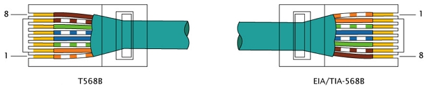

There are two variants of twisted pair cable crimping: EIA/TIA-568A (T568A) and EIA/TIA-568B (T568B). The T568B direct crimp option is normally used:
Table 3. EIA/TIA-568B
No. of cores on one side of the cable
Сore colour
No. of the core on the other side of the cable
1
white/orange stripe
1
2
orange solid
2
3
white/green stripe
3
4
blue solid
4
5
white/blue stripe
5
6
green solid
6
7
white/brown stripe
7
8
brown solid
8

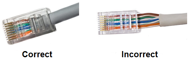

When crimping the ISP Internet cable yourself, first carefully study the core arrangement in the connector. When replacing the connector, you will need to use the same core layout.
When crimping the cable yourself, all the cores must be inserted all the way into the 8P8C connector; otherwise, it may result in poor or missing contact. The outer sheath of the cable must also fit into the connector and be crimped by it, to ensure that the cores fit securely in the connector. All 8 cores in the cable must be in good condition.

1. Connect the Internet cable directly to the network adapter on the computer. Check the connection speed. If it also does not match your PC's claimed speed (e.g. the connection speed of an 8-wire ISP cable should be 1 Gbit/s, but you see 100 Mbit/s), you should contact your ISP for a check and diagnosis of your leased line. If you see the correct connection speed when you connect the Internet cable directly to your PC, but when you connect via a router, it is not always possible to determine the cause, either. If the cable is not up to standard, it is possible that one device or device port may still connect and another may not; it is a matter of chance. Cable quality can only be checked with a specialised device, a cable tester, which is usually available to the ISP.

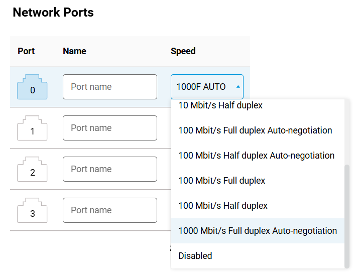

5. On the WAN port, manually set the port mode to 1000 Mbps Full duplex Auto-negotiation instead of the default Auto-negotiation mode. Go to the General System Settings page in the Management menu, under Network Ports, select the mode for the desired port and apply the setting.
