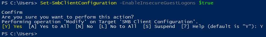

  2. Enable Guest Access for SMB Client in Windows 11.
    In the PowerShell command shell, as Administrator, run the command:
    Set-SmbClientConfiguration -EnableInsecureGuestLogons $true
After running the above commands and restarting the computer, check SMB access to the network drive.
