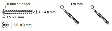

Information on mounting hole spacing and screw specifications:
Model
Carrier (KN-1711)
Distance between holes
67 mm
Head diameter
5–6 mm
Head height
up to 1.5–2 mm
Thread
3 mm
Thread length
at least 20 mm

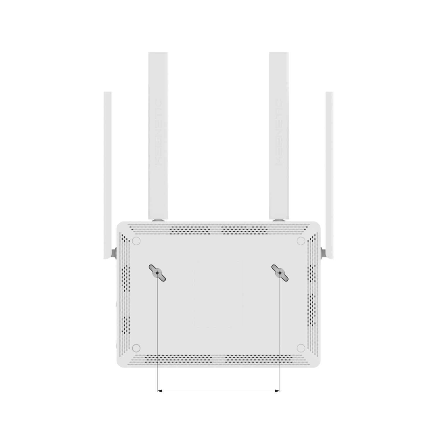

For example, for the larger Keenetic Hero 4G, Hopper, Sprinter, and other models:
Below is the wall mounting template (PDF format) for your Keenetic:
