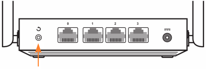

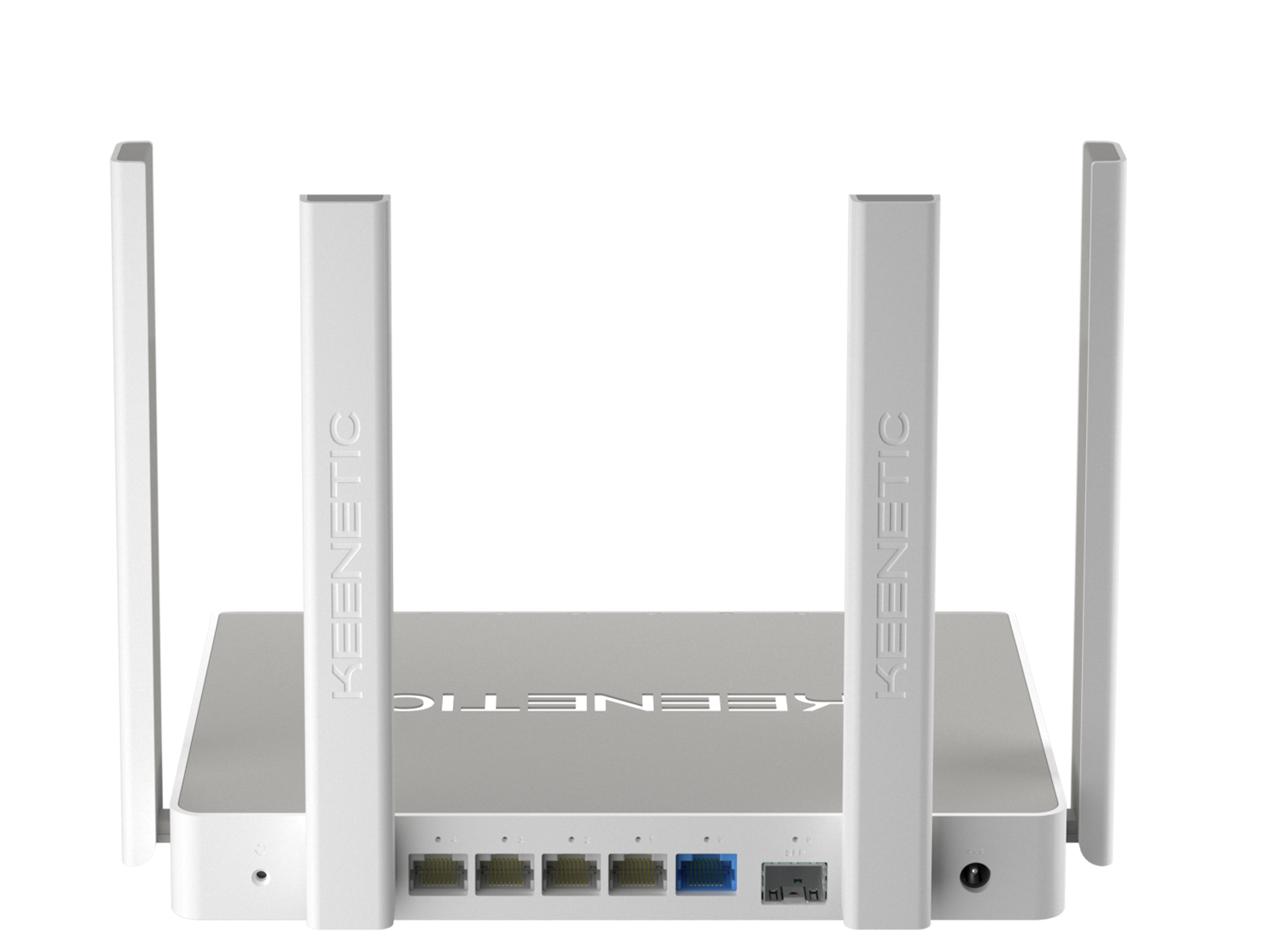

    The device has the Reset button on it. You can find it on the same side of the Keenetic where the rest of the ports are placed (the button's location depends on the model).

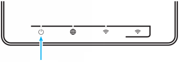

    It is important to pay attention to the Status LED (leftmost) during the reset process, which shows the device state.

    • Press the Reset button using a sharp thin object (e.g. a paperclip) and hold it in until the Status LED on the front panel starts frequently flashing (usually it takes 10 to 12 seconds) and then release the button.
    • After that, the router will restart with the default settings (factory defaults).

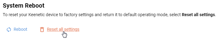

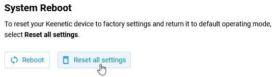

    Go to the General System Settings page. Press the Reset all settings button to delete all user settings in the System Reboot section.

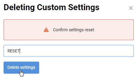

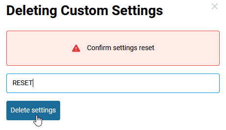

    In the Deleting Custom Settings window that appears, enter the word RESET (in capital letters) in the Confirm settings reset field and click Delete settings button.
    After that, the router will reboot with the default (factory) settings.
