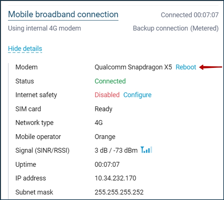

1. Reboot via the router's web interface.
Connect to the web interface of the router at http://my.keenetic.net or 192.168.1.1 — IP address, preinstalled by default. On the 'System dashboard' page, click on 'More details' to display more information and under 'Modem', click on 'Reboot'.
