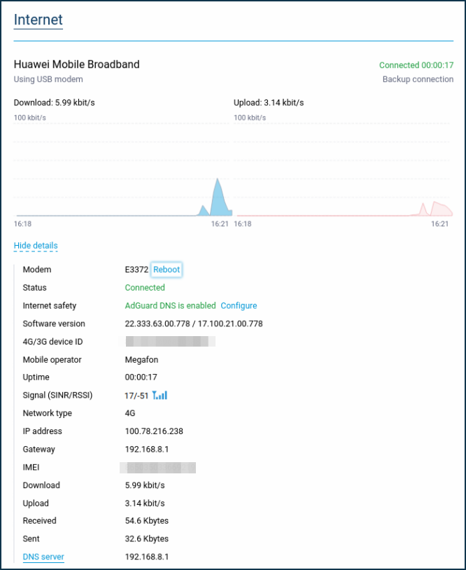

Keenetic routers with a built-in 4G/3G modem or a USB port to connect external USB modems allow you to connect to the Internet via a mobile operator's network.
On the System dashboard page in the Internet section, you can see the current status of the LTE connection.
To measure the signal quality, pay attention to the Signal (CINR / RSSI) values.
CINR (Carrier to Interference + Noise Ratio), also called SINR (Signal to Interference + Noise Ratio), is the ratio of the signal level to the noise level (or simply the signal to noise ratio). The CINR value is measured in dB.
A positive CINR value means that there is a more effective signal than noise. The minimum value acceptable for stable network operation: CINR = 10 dB.

RSSI (Received Signal Strength Indicator) is an indicator of the signal power level received by the modem. The value is measured in dBm. The minimum value acceptable for network operation is RSSI = -85 dBm.

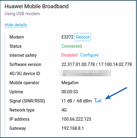

The 'staircase' signal quality icon correlates as follows with the RSSI value (dBm):
  • 4 grades: > -65 (excellent signal)
  • 3 grades: from -65 to -75 (good signal)
  • 2 grades: from -75 to -85 (medium signal)
  • 1 grade: from -85 to -90 (poor signal)
  • 0 grade: < -90 (no connection)

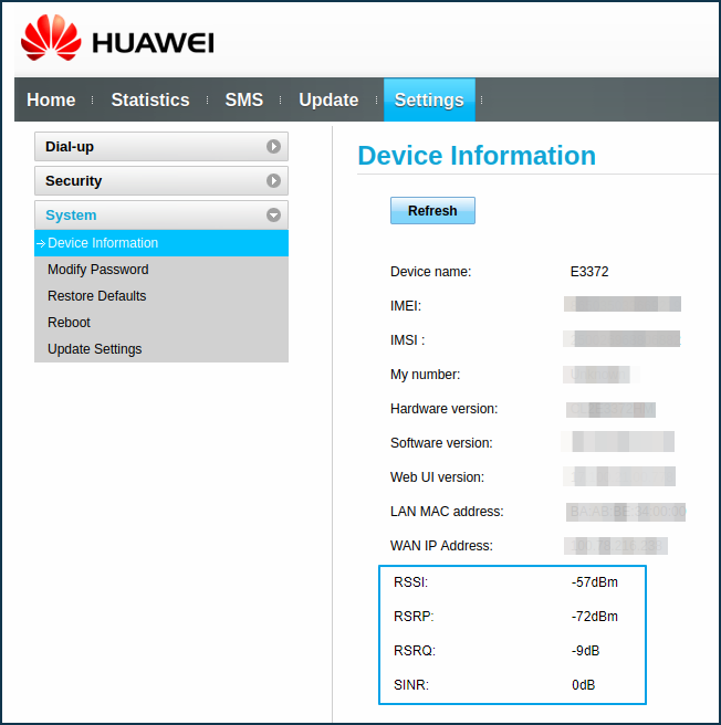

Signal quality parameters in the USB modem interface
If you are using an additional USB modem, connect to its own interface via the IP address assigned to it by your Keenetic router. In our example, the Huawei E3372 modem interface is available at the IP address http://192.168.8.1.
Here is a brief description of the parameters that determine LTE signal quality.
RSSI (Received Signal Strength Indicator) is an indicator of the signal power level received by the modem. An additional description of the parameter was given above.
RSRP (Reference Signal Received Power) is the average power value of received pilot signals (Reference Signal) or received signal level from Base Station. RSRP value is measured in dBm. At RSRP= -120 dBm and below LTE connection may be unstable or not established at all.
RSRQ (Reference Signal Received Quality) describes the quality of the received pilot signals. RSRQ value is measured in dB.
SINR (Signal Interference + Noise Ratio) is also called CINR (Carrier to Interference + Noise Ratio), and in some modems, Ec/Io is the ratio of the useful signal level to the noise level (or simply the signal-to-noise ratio). An additional description of the parameter was given above.
CQI (Channel Quality Indicator). CQI indicators are formed for each customer station (UE, User Equipment) and each carrier frequency block. Depending on the required UE data rate, the base station decides on the number of resource blocks allocated to a particular user, and what kind of frequency blocks to allocate to users depends on the CQI. The resource blocks with the highest CQI and, therefore, the best signal-to-noise ratio are allocated to users. This parameter can take values from 0 to 15. The higher the value, the better (the higher the speed the LTE operator's base station can allocate).

In our example, the screenshot above shows an example of a quality signal on a 4G network (with SINR = 20 dB and RSRP = -72 dBm).
