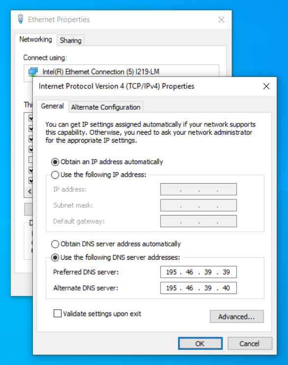

  1. On computers, the IP protocol parameters are manually configured, and the required DNS server addresses are specified in the configuration of the network interface, e.g. as in the screenshot below. The computer's network interface will receive an IP address and default gateway address from the router automatically but will use the server addresses of the public SafeDNS provider as DNS servers.
    This method can be inconvenient when you need to make settings on a large number of client devices on the network or when different devices are connected to the router each time, for which you need to provide the same access conditions.

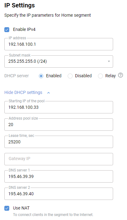

  2. You can specify the required public DNS server addresses in the router's web interface on the 'My netwoks and Wi-Fi' page in the 'IP Settings' section of the DHCP settings, and when you connect clients to its network, the configuration will be performed automatically.
    It should be noted that if you use public DNS servers directly on your computers, you will not be able to access the router by the name my.keenetic.net, as well as take advantage of DNS query caching on the router, automatic selection of the optimal server and other DNS Proxy features.

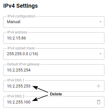

Sometimes ISPs provide the addresses of their own DNS servers so that they can be included in the configuration manually. In this case, you must delete the DNS server addresses specified in the connection parameters. For example, in the web interface on the 'Ethernet Cable Connections to Internet' page, in the 'IPv4 Settings' section in the 'DNS 1' and 'DNS 2' fields, delete the servers.
When accessing the Internet using authentication, e.g. PPTP/L2TP/PPPoE, pay attention to the details provided by your ISP. If they contain the server address in domain name format, you should not disable DNS servers on the connection used for authentication — usually an 'Ethernet Cable Connections to Internet' connection, as it may make it impossible to determine the address of the server providing Internet access. See Note 1 of this article.

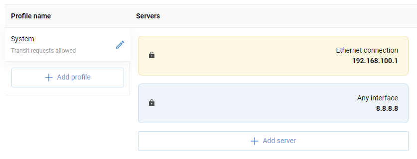

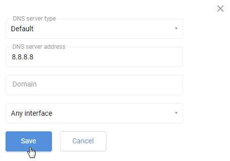

Step 2: Specify the required server addresses manually
This operation can be performed through the device web interface on the 'Internet Safety' page in the 'DNS Configuration' tab.
To specify general-purpose servers that will be used when working on the Internet, you should not fill in the 'Domain' field and change the default value of the 'Connection' field.
