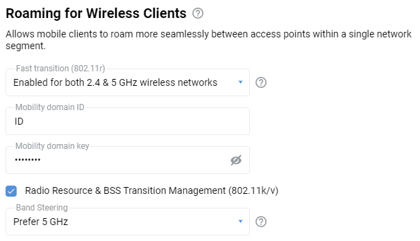

    Before connecting an Extender on the Main Router, activate the settings for seamless Wi-Fi roaming (on the 'Home segment' page). These settings will be automatically transferred to the Extenders once the Wi-Fi System is switched on.
    In the seamless roaming settings, we recommend enabling 802.11r (FT) for both 2.4 and 5 GHz bands, 802.11k/v BSS environment management and setting Band Steering to 'Prefer 5 GHz'. Generally, these settings are the most optimal and universal for the operation of most modern wireless devices.

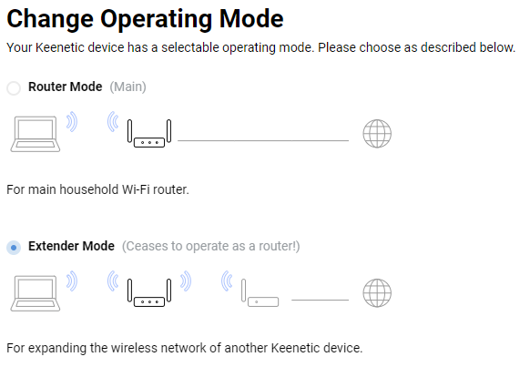

    For models that do not have a hardware switch, enable the operating mode via the web interface. On the 'General System Settings' page, under 'Change operating mode', click 'Change operating mode' and set the Extender mode.

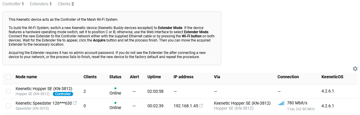

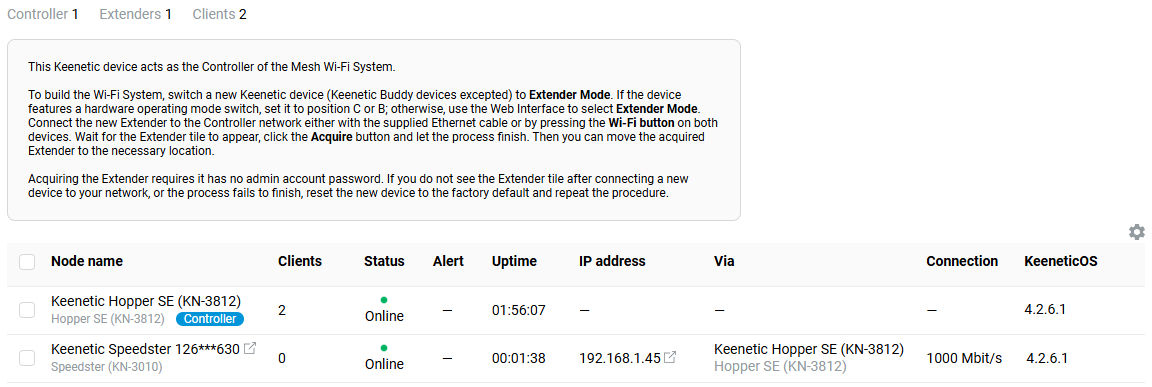

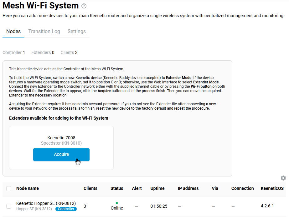

  5. Open the web interface of the Main Router, go to the 'Wi-Fi System' page and click 'Acquire' to add an Extender.
    The Extender's operating system may be updated at the time of acquisition. Wait until the process is completed.
    İpucu
    If, for some reason, the Extender does not appear in the list of available to add or is not acquired into the Wi-Fi System, we recommend performing a factory reset on it and then reconnecting and acquisition.

    If using a wireless Mesh connection, place the Extender in the coverage area of the Main Router. If using a dual-band model as an Extender (Explorer, Speedster, Buddy 5/5S) when taken into a Mesh Wi-Fi System, the wireless connection between routers will only work in the 5 GHz band (this is currently the current limitation of the Wi-Fi system design).

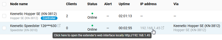

    In the Main Router's (Controller's) web interface, make sure that all nodes in the Wi-Fi System are connected, and client devices are successfully switched between them. Here you can also see the link quality (link speed) between the Extender and the Main Router.
    If necessary, you can access the Extender interface by clicking on its IP address link. When connecting to the Extender, use the password of the administrator account set on the Main Router.

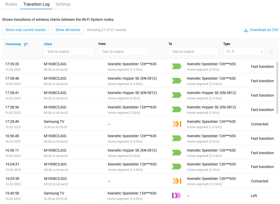

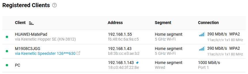

    On the 'Client Lists' page, you can see which node the network clients on the Wi-Fi System are connected to.
    On the 'Mesh Wi-Fi System' page, the 'Transition Log' tab displays wireless clients transitions between Wi-Fi System nodes.
    The following events are recorded:
    • Connected;
    • Left;
    • Transition — standard transition without 'accelerators', the client disconnected from one point and connected to another;
    • PMK cache transition — fast transition using PMKID cache, Pairwise Master Key Identifier;
    • Fast transition — the fastest transition with 802.11r and FT mode.
    The Wi-Fi System uses 802.11r/k/v protocols to switch clients between APs automatically. Still, in reality, the quality of seamless Wi-Fi roaming is very dependent on the client's hardware and the presence/absence of support for these protocols. On clients without 802.11r fast roaming protocol support, Keenetic routers can use PMK cache transition.
