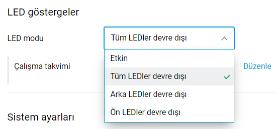

You can control the LEDs using the device web interface, the command-line interface (CLI), or a button on the case.
  1. The web interface, on the 'General System Settings' page, in the 'LED Indicators' section, provides the settings for controlling the LEDs located on the case of the device (this feature has been added in KeeneticOS 3.6).
    The following values are available for the 'Illumination mode' parameter:
    • Enabled
    • Disabled front
    • Disabled back
    • All LEDs disabled

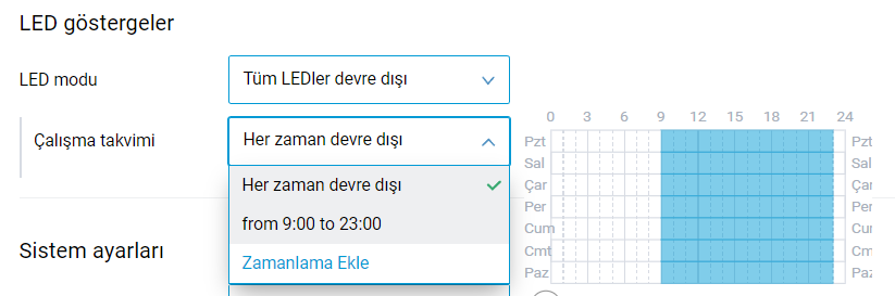

    If necessary, you can set the LEDs (indicators) to turn off according to the specified time. To do this, refer to the 'Disabling all LEDs on schedule' manual.

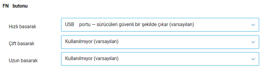

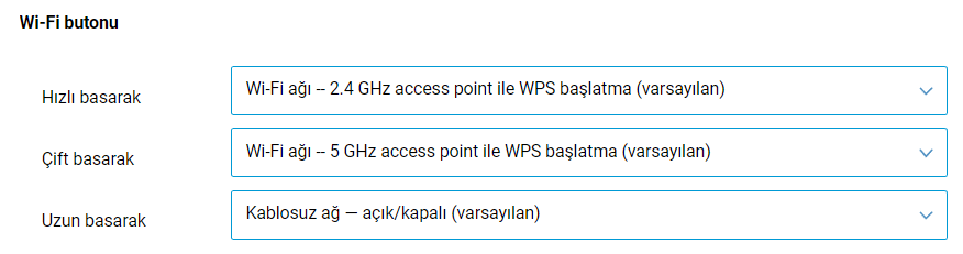

  2. Yönetim’ sayfasında bulunan ‘Sistem Ayarları’ Keenetic butonları ve göstergelerinin fonksiyonları’ bölümünden, ‘Göstergeler – LED açık/kapalı’ fonksiyonunu Wi-Fi veya FN butonuna atayabilirsiniz.
    The first time the button is pressed, only the LEDs on the front panel are turned off.
    The second time only the LEDs on the back panel.
    The third time all the LEDs are turned off.
    The fourth time all the LEDs are turned back on, i.e. the state when all the LEDs are lit.
    After restarting the device, the light indication is restored to the factory preset when all the indicators are lit.

  4. Göstergeleri belirli bir sürede kapatmak üzere konfigürasyon yapmak için, 'Zaman Takvimi ile Led Göster Işıklarının Yönetimi göstergeleri zamanlı olarak devre dışı bırakma' başlıklı yazıya bakınız.
