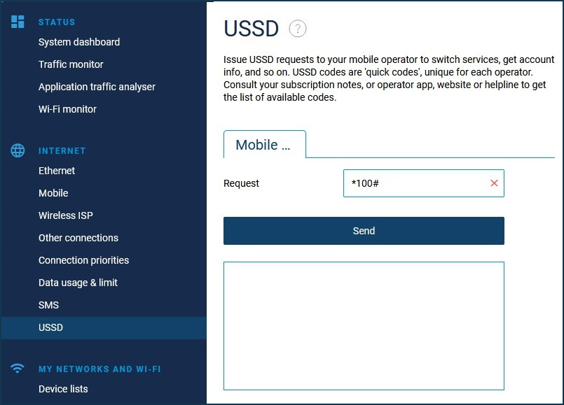

In the web interface, in the 'Internet' menu section, click on 'USSD'. Enter the USSD command (request code) in the 'Request' field and press the 'Send' button.
Codes for USSD requests vary from operator to operator. Please check the list of codes supported by your operator.
