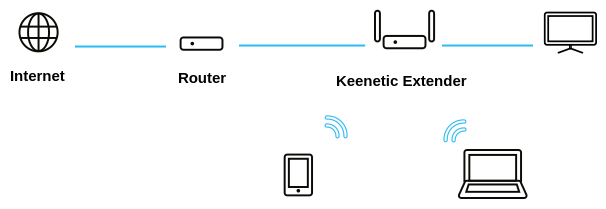

Setting up the Keenetic Extender when connected to the main router over the wire
Switch your router to Extender Operating Mode.
Set the switch on models with a
2-position
A/B mode switch to B. The switch is located on the side of the router.For other router models, the operating mode selection is made in the web interface on the 'General system settings' page. Click 'Change operating mode' and set 'Access point/Extender' or "Extender Mode" depending on the model.
Connect a wire (patchcord) between your Keenetic Extender and the main router. Connect one end of the cable to the LAN port on the main router (home network port) and the other end to any free network port on the Keenetic.
Once the Extender has been successfully connected to the main router, the Internet LED
on the Keenetic body will light steadily.
You can now connect client devices to the Extender via Wi-Fi and wire.

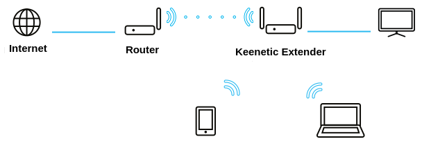

Setting up the Keenetic Extender when connected to the main router over the Wi-Fi
Switch your Keenetic router to Extender Operating Mode.
2-position
A/B mode switch to B. The switch is on the side of the router.For other router models, the operating mode selection is made in the web interface on the 'General system settings' page. Click 'Change operating mode' and set 'Repeater/Extender'.

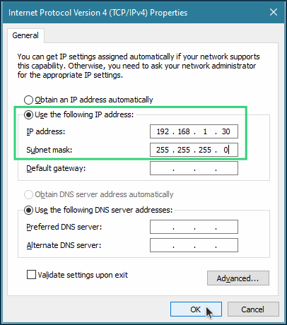

On the computer in your operating system, open the network settings (Control Panel > Network and Internet > Network connections > Connection properties > select 'IP version 4 (TCP/IPv4)' and click Properties).
Manually set to use any IP address in the
192.168.1.4 ~ 192.168.1.254
range with a mask of255.255.255.0
(in our example, we have set the IP address to192.168.1.30

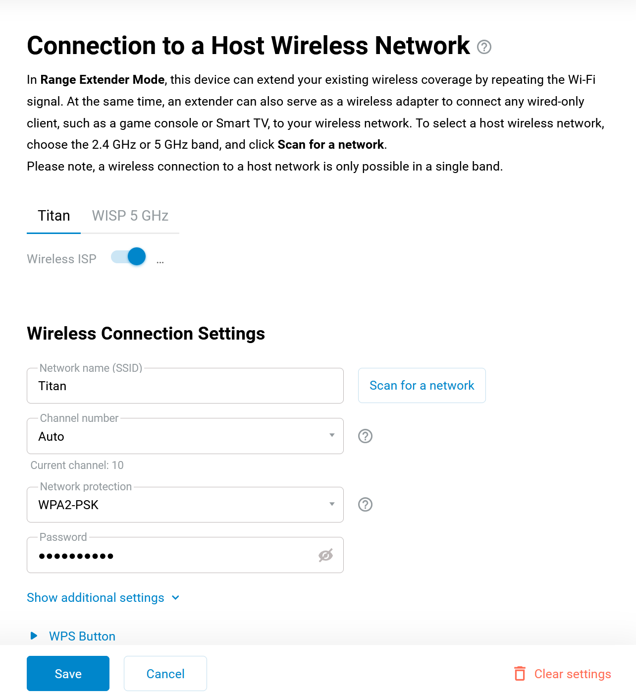

In the web interface, go to the 'Wireless ISP' menu, and on the 'Wireless connection settings' section, click 'Scan for a network' and select the desired network. Then enter the password for the main router's network connection in the 'Password' field. Save the settings.

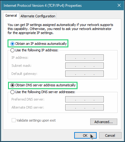

Open the network settings again on the computer ((Control Panel > Network and Internet > Network connections > Connection properties > select 'IP version 4 (TCP/IPv4)' and click Properties). In the protocol properties window, return the 'Obtain IP address automatically' to assign a dynamic IP address and DNS server to the computer's network adapter.
