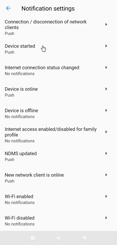

Launch the app and in the 'Locations' main screen, select the required network.
From the selected network settings screen, press 'Events'.
Click on 'Notifications'.

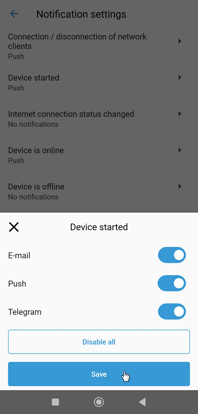

Select the events for which you want to be notified.
Please tap on the events that you want to be notified of when they occur. Select the notification methods. Tap a checkmark in the upper right corner of the screen to save the setting.

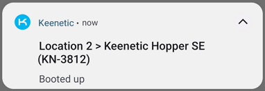

When push notifications are enabled, they will arrive at your mobile device, where the Keenetic application is installed. For example:

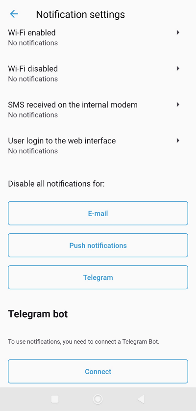

Configuring Telegram notifications
To set up notifications via Telegram Bot (https://t.me/KeeneticNotifierBot), mark the required notifications first.
And then generate a unique code by clicking 'Connect'.
Then go to the https://t.me/KeeneticNotifierBot settings and register the obtained code.
Use the command /register [telegram-code]
For example: /register 2937a360-0d00-11e7-8029-xxxx
Wait for a confirmation message about registration 'Successful registration'.
If you get an 'invalid code' message when registering the key, be sure to run the /unregister command and then register again. Also, make sure you copy the code without any extra characters, such as spaces.
Check the notifications afterwards.
