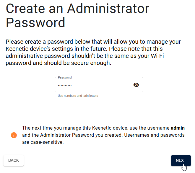

Set the router administrator password and click 'Next'.
In Keenetic routers, it is obligatory to set the password for the administrator (admin) account. This is necessary for protection against unauthorized access to the device settings.
Tip
Set a strong router administrator password at least 8 characters long, including letters and numbers. A strong password is a password that is difficult to guess and takes a long time to pick by brute force. You can check the password strength here.

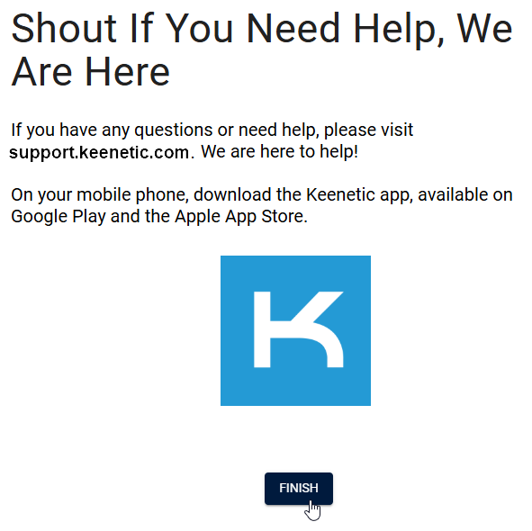

So, the Keenetic router Initial Setup Wizard is complete. Click the 'Finish' button.
Visit account.keenetic.com to create your Keenetic Account and register your router. By registering, you will always know the exact duration of your device's warranty. In addition, the Keenetic Account is one-stop access to the Keenetic mobile application, Keenetic RMM service and Keenetic Cloud web portal.

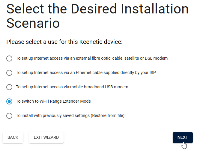

Enabling Extender Mode
Keenetic router can operate in one of two modes — 'Router' and 'Extender'. The optional Extender Mode is used to increase another router's existing Wi-Fi network or connect network devices. To use your router in advanced mode, select 'To switch to Wi-Fi Range Extender Mode' in the 'Select the Desired Installation Scenario' screen and press 'Next'.
Next, you will see information on how to connect the Extender to the Mesh Wi-Fi system.
