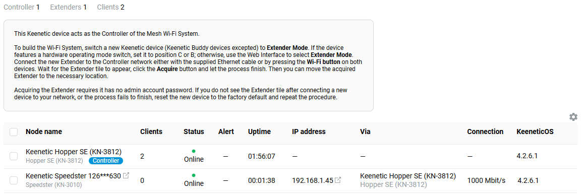

The Controller function is to be configured in the web configurator on the Mesh Wi-Fi System page. Once connected, the Extender will appear on the Devices tab in the Nodes available for adding to the Wi-Fi system list.
Before adding a new device to the Wi-Fi System, perform a factory reset on the Extender using the Reset button on the device's body.
The Controller will automatically detect the version of the Extender operating system and, if there is an update, will install the latest version of the device operating system. Click the Acquire button to add the Extender to the Wi-Fi System. Wait for the process to complete.
After a capture, the device will appear in the list of Extenders.

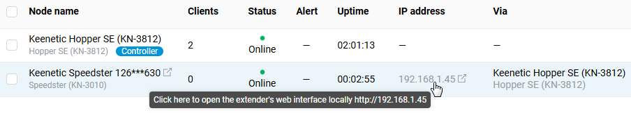

After adding Extender to the Wi-Fi System, you can access its web interface. Click on the Extender's IP address link.
When connecting to the Extender interface, use the administrator account password set on the Controller.

On the Mesh Wi-Fi System page, the Devices tab displays all Extenders – new, available for addition, and previously captured, already part of the Wi-Fi System.
