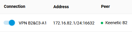

    3.4 Switch on the configured VPN interfaces on Routers A1 and B2. If everything is configured correctly, a green connection status indicator should be displayed in the Peer column.
    Keenetic A1:
    Keenetic B2:

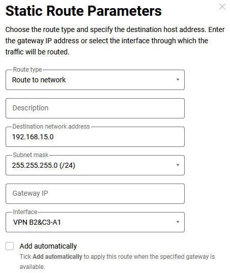

    4.2 The 'technical' addresses of the network designated at the ends of the tunnel — 172.168.82.1 and 172.16.82.2 — can already exchange data at this stage. To send traffic through the tunnel to the remote networks required by the diagram, it is necessary to add routes on the routers (Routing menu → Create route button).
    Keenetic A1 — route to the 192.168.15.0/24 network through the tunnel:
    Keenetic B2 - routes to networks 192.168.111.0/24, 192.168.112.0/24 and 192.168.26.0/24 through the tunnel:
