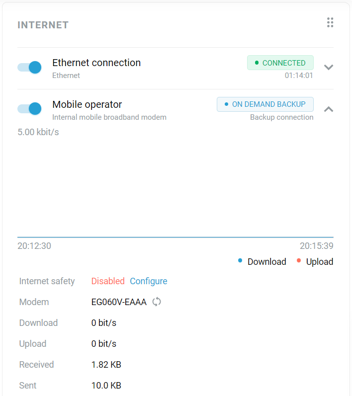

The Standby (on demand) mode is not in use:
The Standby (on demand) mode is on:
