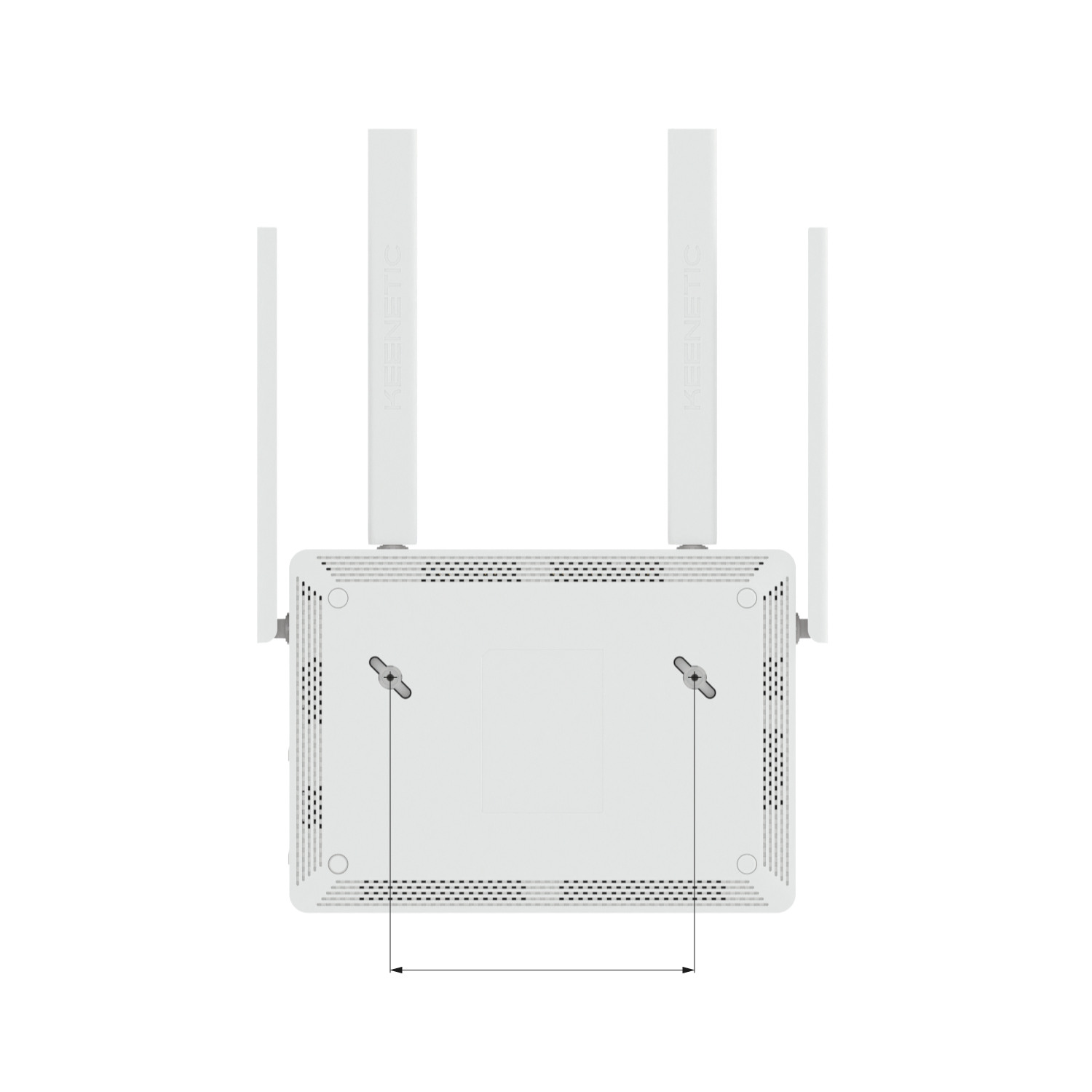

All Keenetic router models have a wall mount option. There are two holes on the back of the case.
Mounting elements (self-tapping screws and wall plugs) are not included with the router.

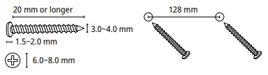

Information on mounting hole spacing and screw specifications:
Model | Titan (KN-1810) |
Distance between holes | 128 mm |
Head diameter | 6-8 mm |
Head height | up to 1.5-2 mm |
Thread | 3-4 mm |
Thread length | at least 20 mm |
