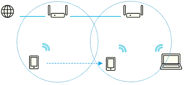

Wi-Fi roaming function provides a permanent connection to the Wi-Fi network of mobile users (smartphones, tablets, notebooks) during their movement within the coverage area created by several autonomous access points. When moving within the coverage area, the mobile client independently selects the most suitable access point depending on the signal level, network load and other factors. This is especially important to ensure a stable connection when using IP telephony.
For example, two Keenetics are in the Router mode and another in the additional mode 'Extender' ('Access point/Extender' or 'Repeater/Extender') to extend the main router's coverage area. If seamless Wi-Fi roaming is enabled, then accelerated reconnection between the access points will occur when you move with your mobile device around the apartment.

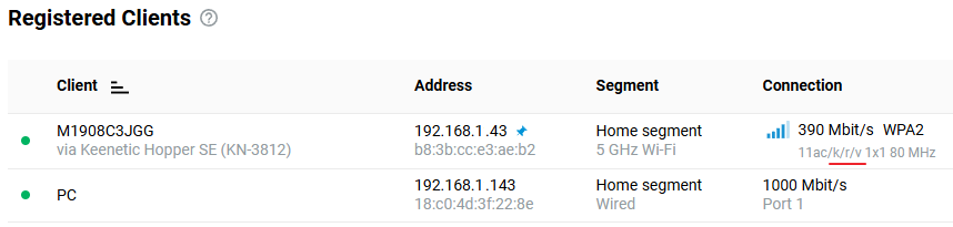

'Client lists' page displays the roaming standards that each Wi-Fi subscriber device supports. 802.11k/r/v roaming features must be enabled. Otherwise, they will not appear in device properties.
