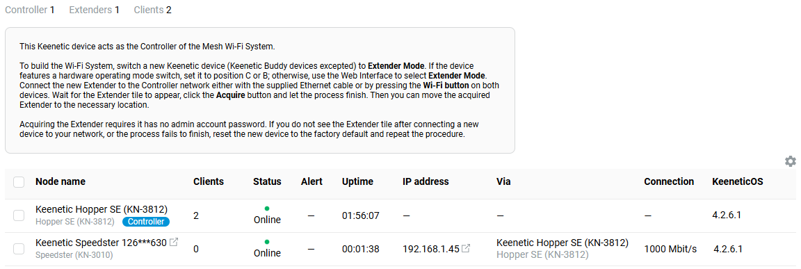

  5. Open a web browser, go to my.keenetic.net, log in to the Main Router's web interface. Open the Mesh Wi-Fi System page and click Acquire to add the Extender to your Wi-Fi System.
    At the time of integration, the operating system of the Extender may be updated.
    Wait until the process is complete.
  6. Disconnect the Extender from the Main Router and move it to the location in your home to increase Wi-Fi coverage. If the Extender is successfully connected to the Wi-Fi System, the indicator internet_led.png on the Extender will illuminate.

  5. Open a web browser, go to my.keenetic.net, log in to the Main Router's web interface. Select the Wi-Fi System section and click Acquire to add the Extender to your Wi-Fi System.
  6. Move the Extender to the location in your home to increase Wi-Fi coverage. If the Extender is successfully connected to the Wi-Fi System, the indicator internet_led.png on the Extender will illuminate.
