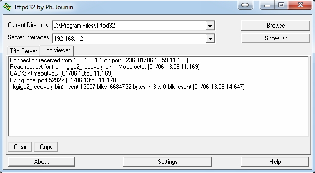

  3. Download and install a TFTP server such as tftpd32 on your computer.
    Put the firmware file (bin file) for your model in the installed TFTP server's folder (the default folder is C:\Program Files\Tftpd32).
    Run the TFTP server.

  5. Hold down the Reset button and turn on the router's power.
  6. Release the Reset button when the Status LED on the router starts flashing.
    Reboot the device to leave the recovery mode without restoring the KeeneticOS.
    Keenetic should get the file with the firmware from the TFTP server and write it into the non-volatile memory.
  7. In about 5–7 minutes, the device will reboot and be ready to work with the new firmware.
