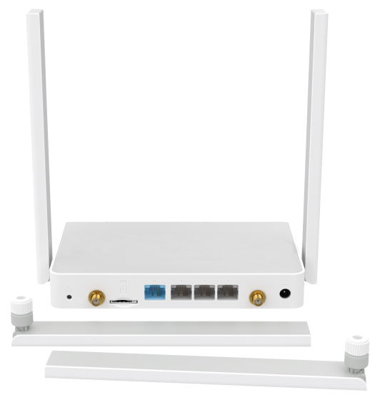

Keenetic Runner 4G (KN-2211) has connectors on the housing for external broadband 5G/4G antennas (for the built-in 5G/4G/3G modem). The package includes removable LTE antennas (for more information on them, you can see the Characteristics of supplied removable LTE antennas article).
The optional outdoor MIMO antenna (with two wires) or SISO antenna (with one wire) can be installed instead of the supplied indoor LTE antennas for operation at greater distances from base stations. The antennas are to be purchased separately.

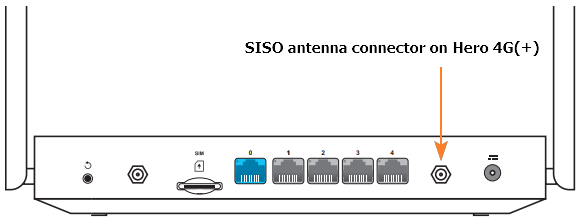

When connecting the SISO antenna, use the following connector on the case.
