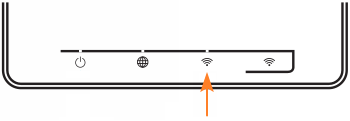

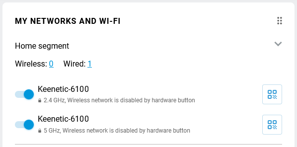

5. Wi-Fi LED does not light up during operation, and the status of the access point in the device's web interface is ‘Turned off by a hardware button’ (in this case, Wi-Fi cannot be turned on by the Wi-Fi Button)
The wireless access point is enabled by default. The wireless network indicator wlan-led.png should be lit when the Wi-Fi network is enabled and should flash when data is being transmitted. If this does not happen, the possible cause is a hardware malfunction of the device (in particular, a malfunction of the wireless module).

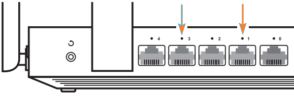

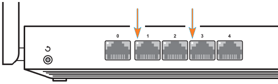

6. When the device is in operation, none of the LEDs on the home network (LAN) connector light up when an Ethernet network cable is connected
Some models of routers and access points are equipped with these LEDs. The indicator above the port should light up when a connection to a client is established and flash when data is being transferred.
A possible cause is a hardware malfunction of the device (in particular, a malfunction of the built-in network switch).
